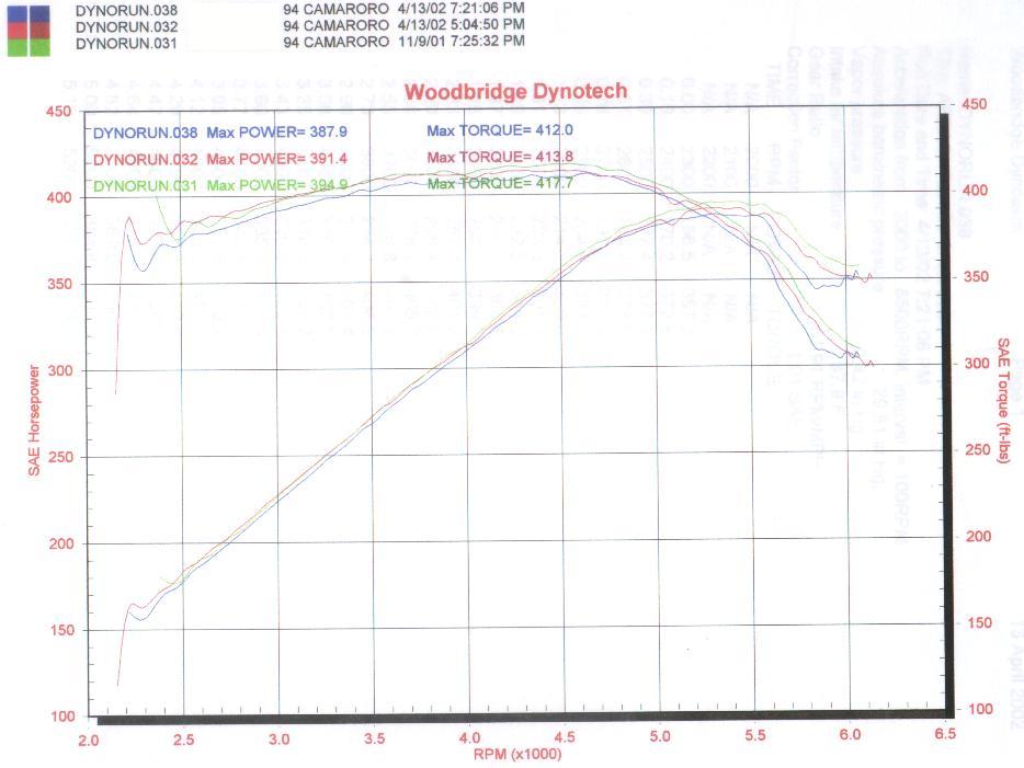

Hmmm....what were the torque numbers on the pulls with what looked like valve float issues? I have a dip at about 5600 that didn't go away with new springs :
http://afrashteh.com/dyno4.jpg
If I remember correctly, you have a 383. I have 30 lb injectors now (was absolutely necessary as the 24s were tapped at 4500). What pump did you go with?
