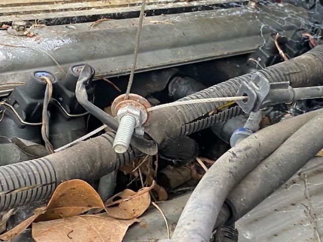

I'm trying to get my dads old car running but it wont start i replaced one of the pigtails that got cut and i have good fuel pressure new oil and new battery it turns over but wont actually start. any and all help will be appreciated i don't know much about cars but ill do the best i can

You really need to do everything listed above that you haven’t already done. The photos appear to show the car to be in poor condition. In that condition, doing any kind of speculation as to the cause, without systematic, thorough diagnostics is a waste of time. The injectors need to be professionally cleaned, or replaced with new or reconditioned units. You have to have at least 40 PSI fuel pressure at the rails
