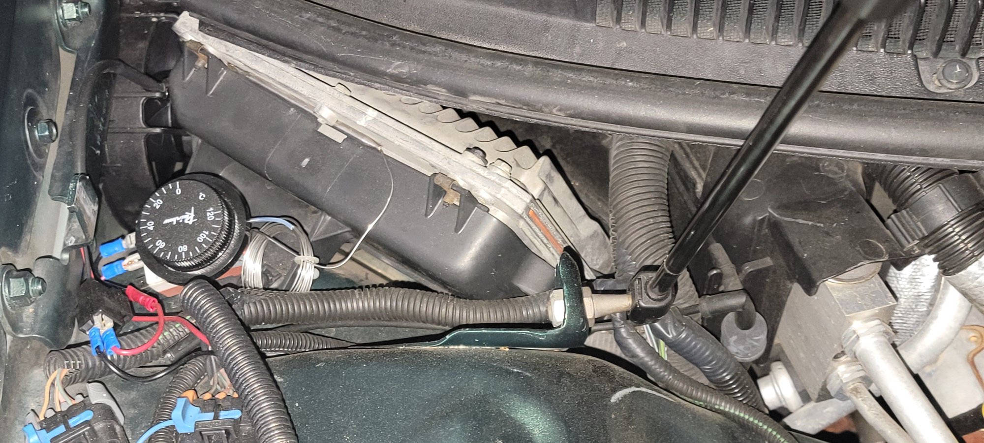

I have devised a temporary workaround by wedging a DC fan with thermostat control probe connected to the PCM that will kick on when the probe senses the PCM shell reaches a predetermined temperature I set with a thermostat dial. The fan will kick on and cool the PCM to help minimize the issue.
However, I find blowing hot air on the PCM can drain the battery over time, so it may be time to replace the PCM.

Curious about the “thermostat control probe”. Is that simply an additional coolant temp sensor screwed into an available port (e.g. - passenger side head between #7 and #8 plugs)? Or is this some sort of sensor integrated into the thermostat?

Regarding the thermostat/fan with probe, I am attaching a picture. The probe is attached to the top of the PCM case.

I guess the “thermostat” switch is actually a stand-alone “thermostatic” switch.

The thermostat switch is stand alone. I bought the fan and thermostat online. Pretty loud when it kicks on - lol.

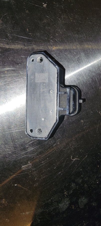

Thanks Injuneer for that info. I replaced the ICM this evening. I made sure to use the grease on the back of the new part. I bought the ACDelco part ($130). I pulled the old one off which also had the grease applied but the old part does not look like ACDelco. I did clean the grease off to check part numbers.
