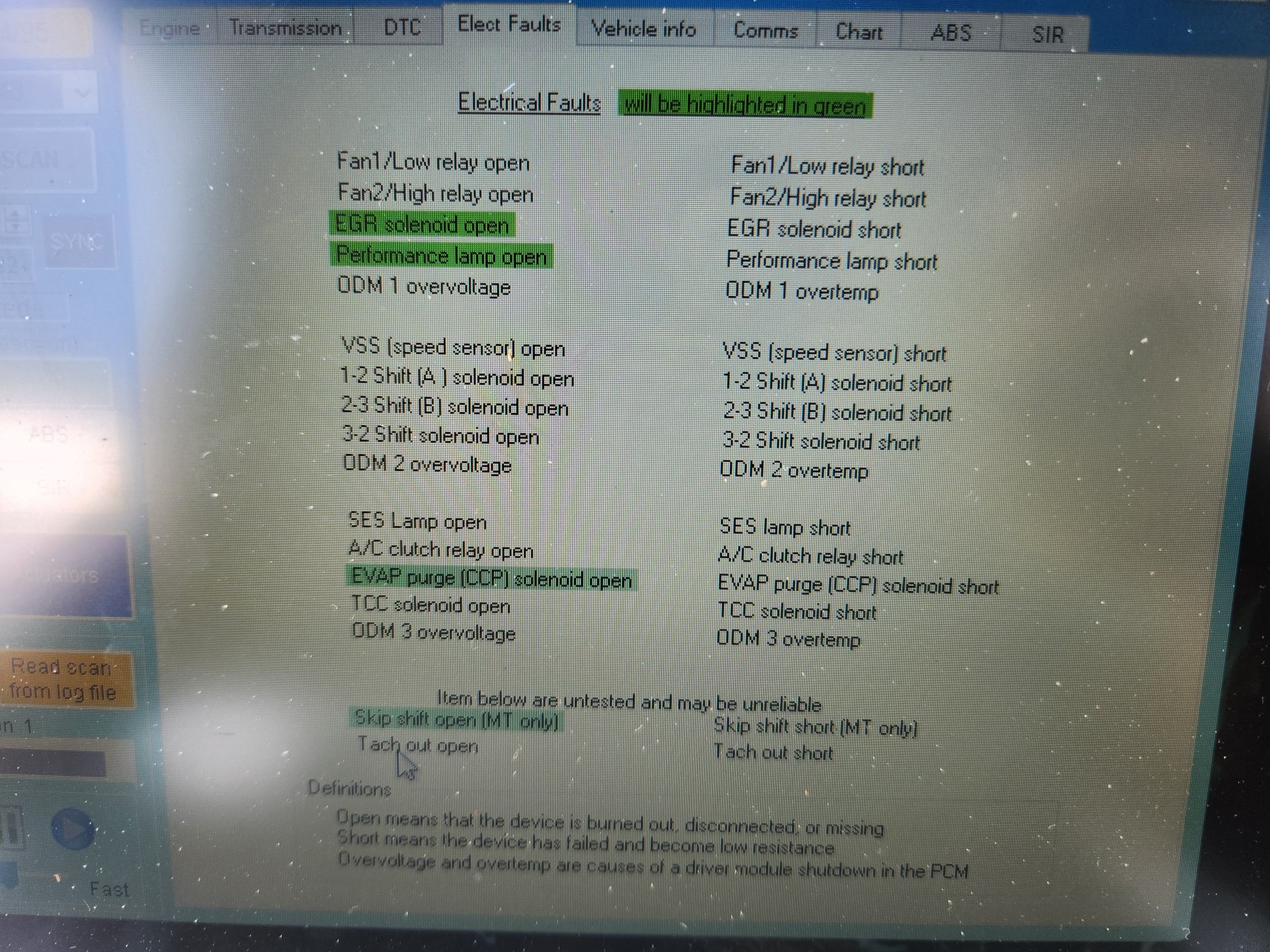

I did download scan 95 and i have 0 codes all I saw is that , I am not an expert and yes once SES light is on remain on .

I have the impression that the SES light is on due to the deleted-but-still-enabled EGR system.
Codes will appear on the DTC (diagnostic trouble code) tab. What do you see there?

Looking over the electrical faults, I’d expect to see codes for EGR and EVAP.
EVAP (evaporative emissions) in particular is likely what’s causing the smell. I know close to nothing about how it works on an LT1 car, so I’ll let Fred take it from here.

Use the “DTC” tab for codes.
The electrical fault tab shows three faults, in green.

As I think more about it, I think you should check the wiring and connector for the evap purge solenoid. That electrical fault says that the circuit is open, which means it’s not connected. You want to make sure it’s connected and that the wiring is in good condition. If it is, then the solenoid itself has likely failed, in which case you should replace it.
The solenoid mounts to the intake manifold, and looks like this: https://a.co/d/09J0SG2W
If you need to replace it, the link above is a quality part at a good price. Feel free to shop around for a better price, but as with all sensors, the OEM supplier (ACDelco) is generally the one to buy.
Replacement is simple: disconnect the sensor and the vacuum lines, then remove. Installation is the same in reverse.
