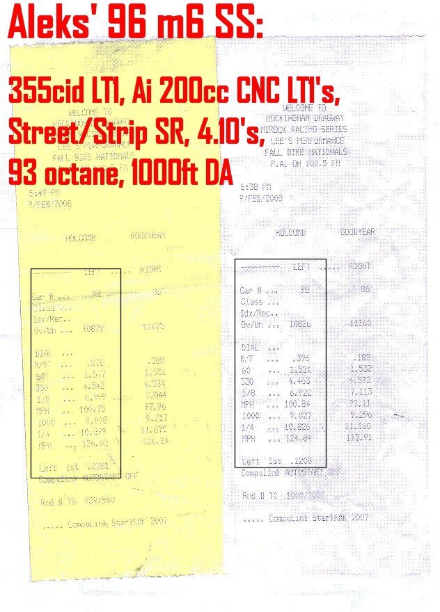

Thanks for the compliments, I appreciate it guys. It's nice to get down the track without destroying drivetrain. The car is running an F.A.S.T. Classic bank to bank EFI, and a stock vented opti spark. Race weight is 3320 and I am running a 4.10 gear. My 60's where in the 1.5's, but as you can see in the video it was bogging down pretty hard. I have to do some calculations and figure out a new rear end ratio and launch rpm. I've had the power for awhile with this engine to go mid 10's and high 120's, but have to get the setup dialed in.

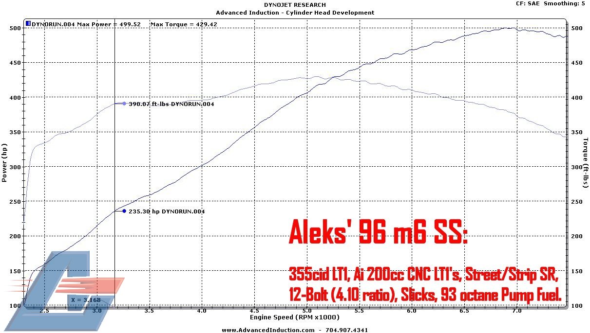

Here are my dyno graphs:
SAE
and
STD
Here are my time slips:
timeslips

I am glad you guys like the sound! The tapes do it no justice, Ive never heard an LT1 like it. When I set up the engine I was using a stock ECU, so Ai set the cam to peak around 6900-7000 (it does). However, the springs are set up to handle more rpm (originally for safety margin). So when I installed the F.A.S.T. I started shifting higher & higher, and the
multiple hits on the rev limiter were 8,000 RPM!! It was only down 20hp (480) at 7500, so I've been trying to shift there. The exhaust is a set of pace setter 1 3/4" headers with my own custom X-pipe exhaust. It has awesome ground clearance, but may be too loud for street use. For the past year I've just used band clamps to quickly swap back to my SLP 2OTL for long distance cruises. It works pretty good, I can swap exhausts in 10 mins or so.

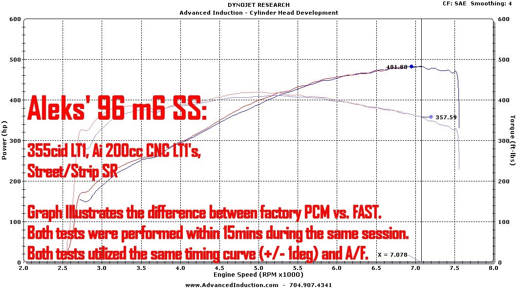

An aftermarket ECU will not change the way a car performs, it only changes the method of communication.
Here is an example of F.A.S.T. Vs. my stock ecu.
My top end (cam, heads, springs, intake) makes it possible, and reasonable, to turn more RPM. The F.A.S.T. lets me operate in this range, so that is the advantage my particular application has over a stock ECU.
I have to admit that I am pretty surprised with the stock opti spark and coil. It will be interesting to see how many times it can see over 7,000 RPM before it fails.
