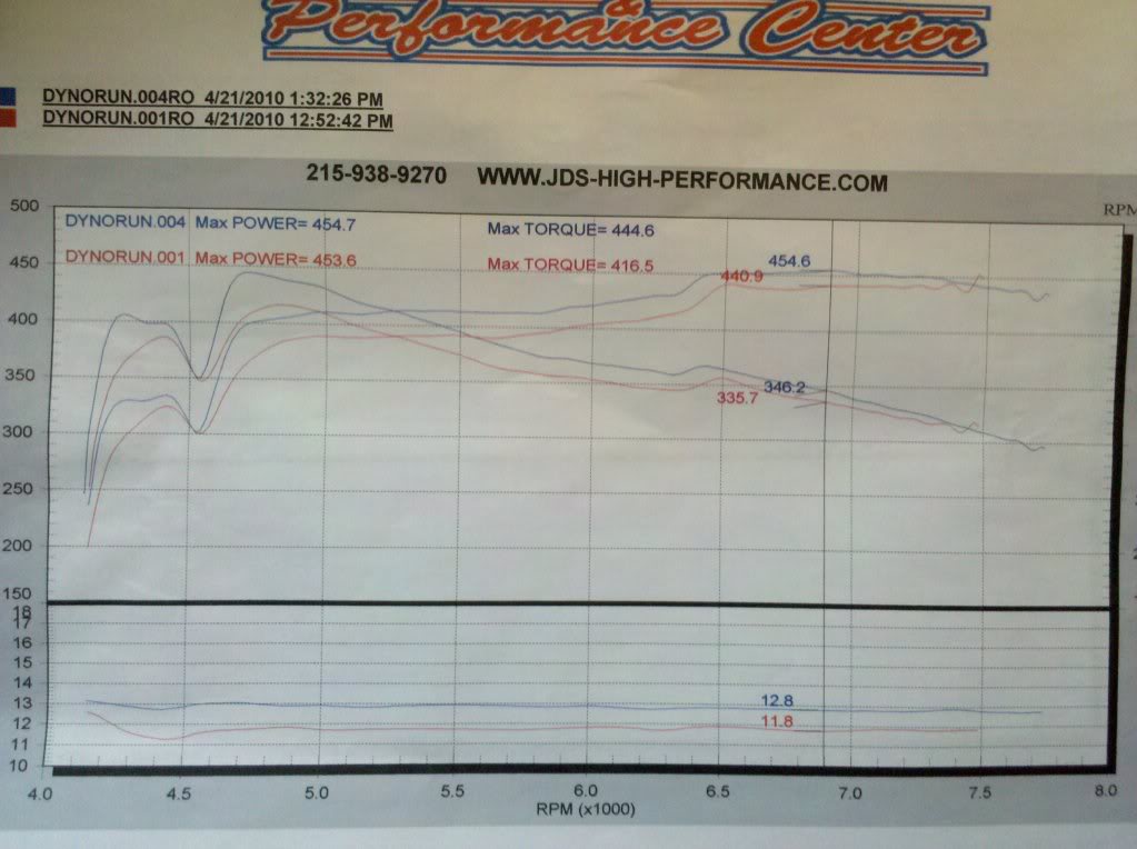

Any chance you have a dyno graph available for posting? I like your numbers but since I'm not a drag racer I'd like to see where the engine makes its power. Congrats on the excellent times. They are quite impressive.
Sure do. Here ya go:
