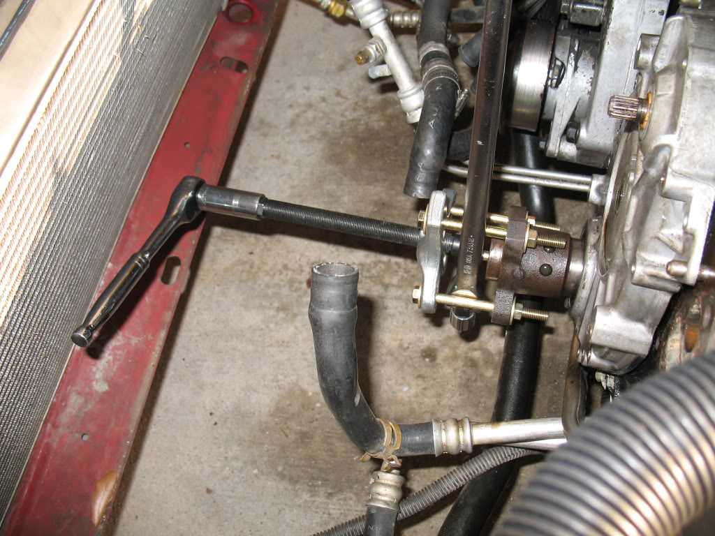

this is what I did. For the center bolt I used the same kind of bolt that you see on the sides. Make sure everything is well centered and it should come off with ease.

I think some of you are confusing a "jaw" puller with a crow's foot puller. The crow's foot as shown just above is what you want (it's a relatively normal balancer puller). A jaw puller has legs with hooks on it to grab things like gears and such.
