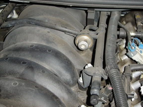

Just so I can get this straight once and for all, I snapped a picture of the drivers side fuel rail this morning to show you what the techs showed me yesterday. Im looking at the small silver object in the middle of the fuel rail. The part they showed me looked exactly like this, and it was identified as the Fuel Pressure Regulator. If it is not, I would love to know what it is so that I can go back to the dealer and get the right info on the FPR

I always thought that that part was a cushion to absorb the shock of extra fuel when you go from WOT to closed throttle.
If it was a regulator then there would be a fuel return line going from the fuel rail to the gas tank.

And that is why I was so confused yesterday when they pointed it out to me. There was no return line anywhere (as is expected on the LS1) The fuel hose feeds directly into that little silver thing on the fuel rail and then splits between the rails. It makes a lot more sense that it is a cushion rather than a pressure regulator.

It appearsthat they were not looking up the correct part number. Even though I told them that I hada z28, they still looked up the part for the V6 (Duh!). Only reason I found out was I looked up the procedure in the hayes manual, and there was the fuel pump regulator they showed me yesterday.
