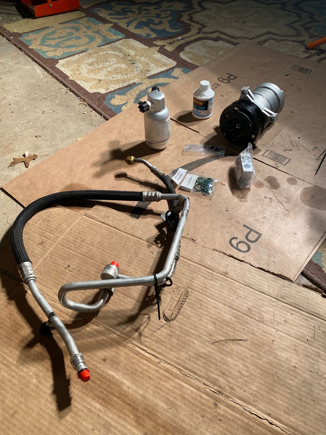

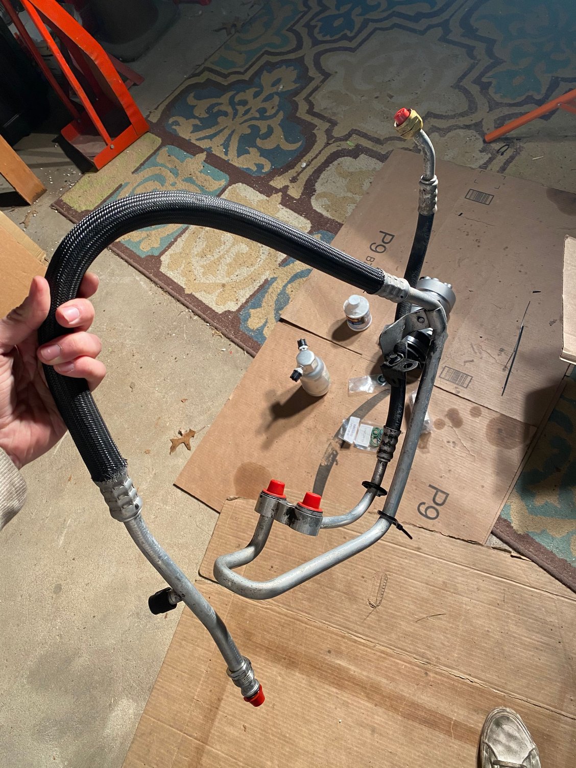

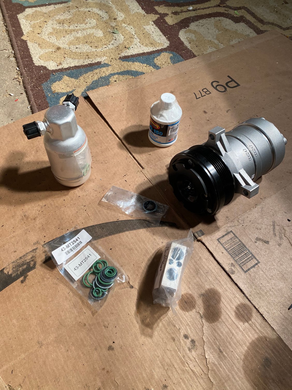

Does anyone have a comprehensive list of the things you would need to re-install all of the AC components?
I have a 1995 Z28 and the previous owner decided to rip out all the AC (probably not for good reason) and now that I want it to be a reliable daily with all the creature comforts, I have to take matters into my own hands. I am not very confident on how to install the parts either and youtube wasn’t much help.
This is what i’ve got so far:
Im pretty sure I still need the accumulator hose and Idk more than that

id get a new condensor and dont forget the desiccant as well, im sure theres a ton of moisture inside the condensor, which has potential to damage everything else in the ac system. other than that im sure thats all youre gonna need
