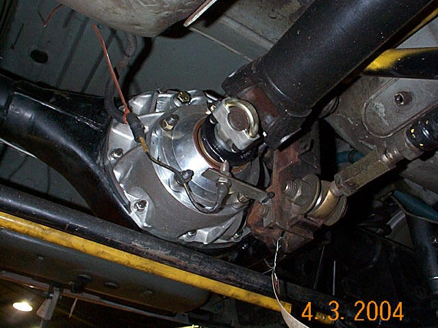

I've had my Strange 12-bolt/3.73 for 20 years. At one point, when the car was still an M6, I was doing 5,000+ RPM clutch dumps, through a McLeod Street Twin, on full slicks, well prepped track. Admittedly, did not run it every week, only made a few passes on a weekend once in a while, and not much of anything for the last 5 years. 12-bolt is still intact, although eventually I switched to a TH400 trans and 4.11 gears. Strange customer service was faultless.
The 12-bolt weighs less, although your aluminum case and gun drilled axles will reduce the difference. Power loss through the 12-bolt is 7% vs. 10% for the 9-inch (source - National Dragster article by Evan Smith, Technical Editor).
The Spohn torque arm attached to the 12-bolt has been problem free for at least 15 years. As I recall, the torque arm problem was unique to the Moser 12-bolt, because unlike the Strange, the Moser torque arm attachment used 4 individual bolts, threaded directly into tapped holes in the housing. The bolts tended to come loose. The Strange version uses two meaty through bolts on the torque arm mount, similar to the stock design.

1 - if they all bolted to the stock 10-bolt, they should all bolt to a Strange 12-bolt. As I recall, a tiny radius had to be ground off the sharp corner of either the upper or lower plates on my Spohn torque arm. But I've had at least three different Spohn TA's (he sometimes used my car for prototype installs and test fit-ups). The current one had to accommodate the unique combination of the TH400 trans, Gear Vendors O/D, and a significantly shortened driveshaft.
2 - No alterations of the body at all. With the optional (recommended) LPW aluminum cover, I had to rotate the stock sway bar U-bolt assemblies slightly to move the sway bar back slightly, so it wouldn’t hit the bottom of the cover. Now with the Spohn 1-5/16” solid chrome moly “drag” sway bar, and his u-bolt mount kit, no longer a problem. Also had a couple friends advise me to make sure the stock panhard rod upper brace didn't contact the cover preload bolts when the rear squatted, but it was never a problem on my car.
