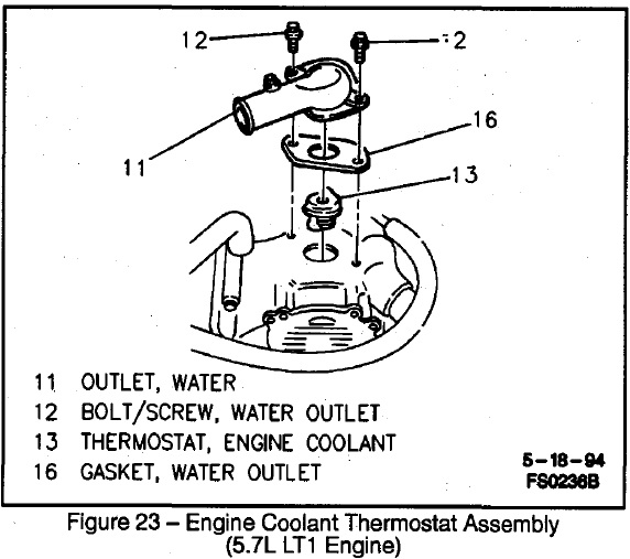

Should I use a thermostat gasket between thermostat housing (water outlet) and a water pump or a rubber o-ring only? For example, rockauto and other autoparts stores doesn't know anything about this gasket and the picture from shbox.com website tells exact the same "no gasket other than the o-ring". But I have downloaded a service manual book for the '95 f-body, that have a picture of something very similar to a gasket and calls it that way.
Image from shbox.com website: http://shbox.com/1/tstat.jpg
Image from the service manual book is in the attachment.
Thank you!

In the Shoebox photo, the black rubber ring around the edge of the t'sat is the gasket. No additional gasket required. Service manual is incorrect. Happens once in a while. For example, the auto transmission section in the 94 and 95 factory manuals references truck applications, not the F-Body.
If your t'stat doesn't have that rubber ring, you probably have the wrong one.

Thank you! Now it's clear for me.

The correct thermostat should come with the o-ring on it. There should be nothing else to buy.

I thought what I wrote was pretty clear. Did you look carefully at Shoebox's photo, it shows the Hypertech t'stat, exactly as it came out of the Hypertech box, with the rubber ring.
