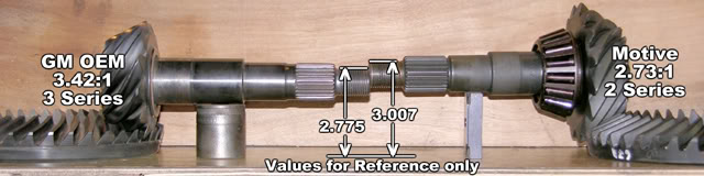

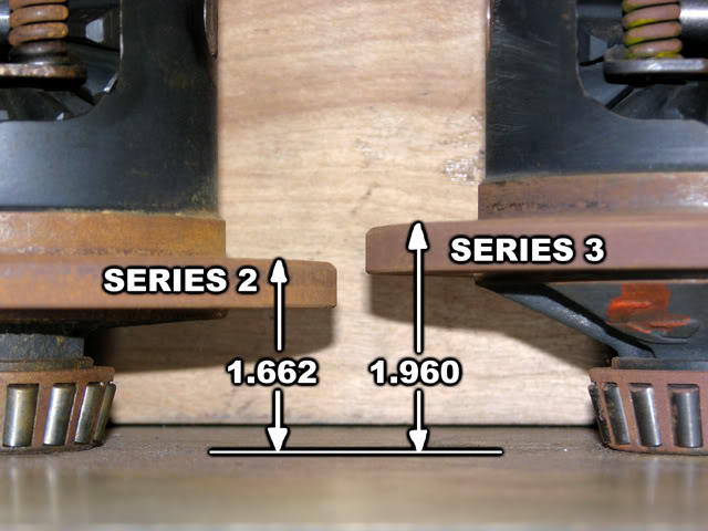

A 2.73 rear end has a 2 series carrier which will work with 2.41,2.73,and 3.08 gear sets. Also available from aftermarket gear manufacturers for 2 series carriers are 'thick' gear sets of 3.42,3.73,4.10.
A 3.23 rear end has a 3 series carrier which will work with standard gear sets of 3.23,3.42,3.73,3.90,4.10,4.30,and 4.56.
It sounds like you're trying to use a regular 3.42 gear set on a 2 series carrier(your original rear end). If so,you'd need a 'thick' set.
for reference:
