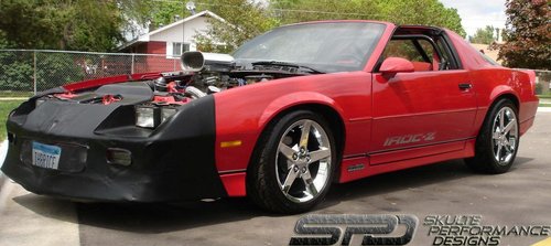

Hi, I've got a 3rd gen here, and I was wondering, is it possible to add cround effects to a car that never had them originally? If so, do I need to do anything special or do they just bolt right up? At first didn'tlike the look of the GFX on 3rd gens but they've grown on me.
Also, I don't want my 3rd gen to sit obnoxiously low, but I would like a little bit of a drop. I'm basically hoping to have it so the fender sits right about level with wheel. I was hoping that maybe IROC springs would get me the look I'm going for?
I was looking for a fender-to-tire clearence of something like this:http://www.skulte.com/slideshow/Camaro_4_001.sized.jpg
