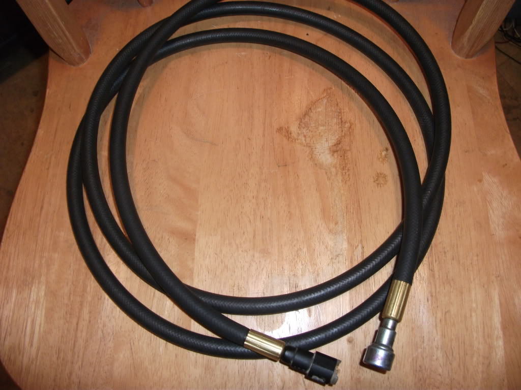

had this problem with the underhood and pump to filter line on my 97 v-6. Hose man used my original connectors and 350psi line with hydraulic crimps and made me new lines. Worked perfect!
