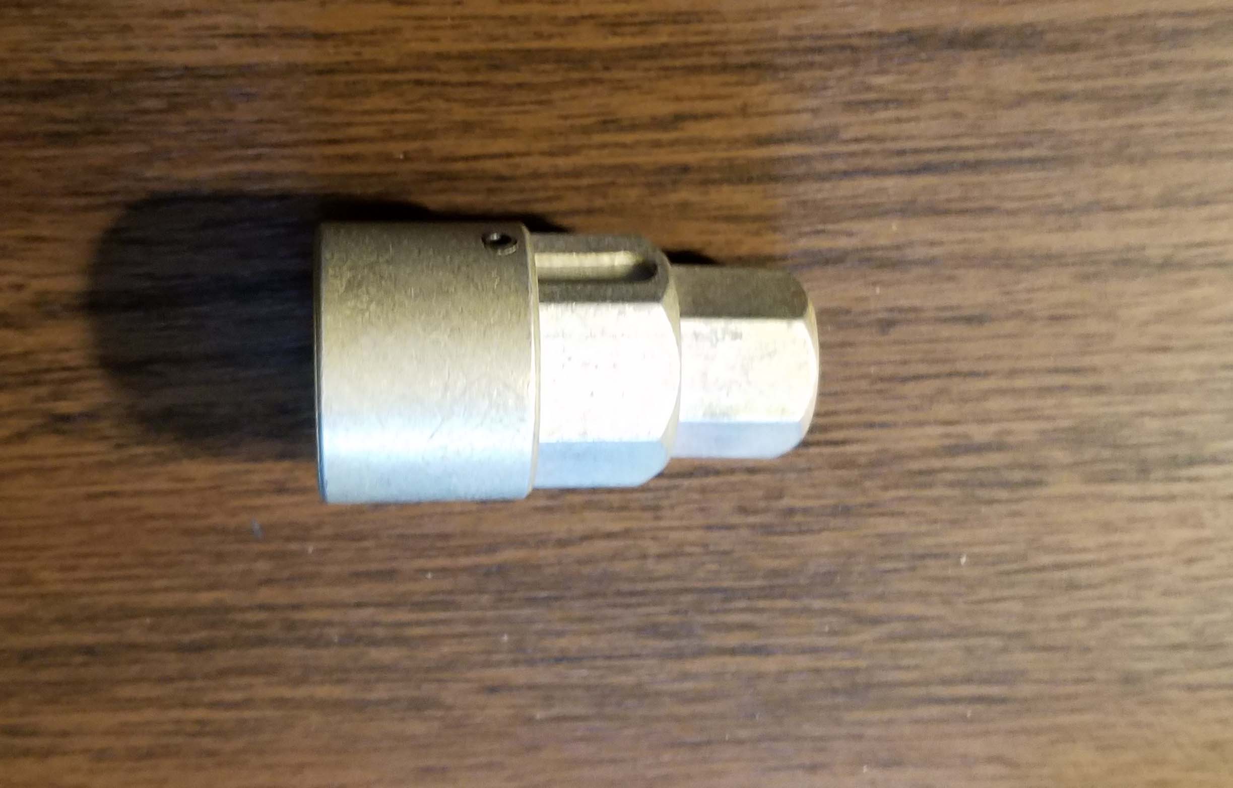

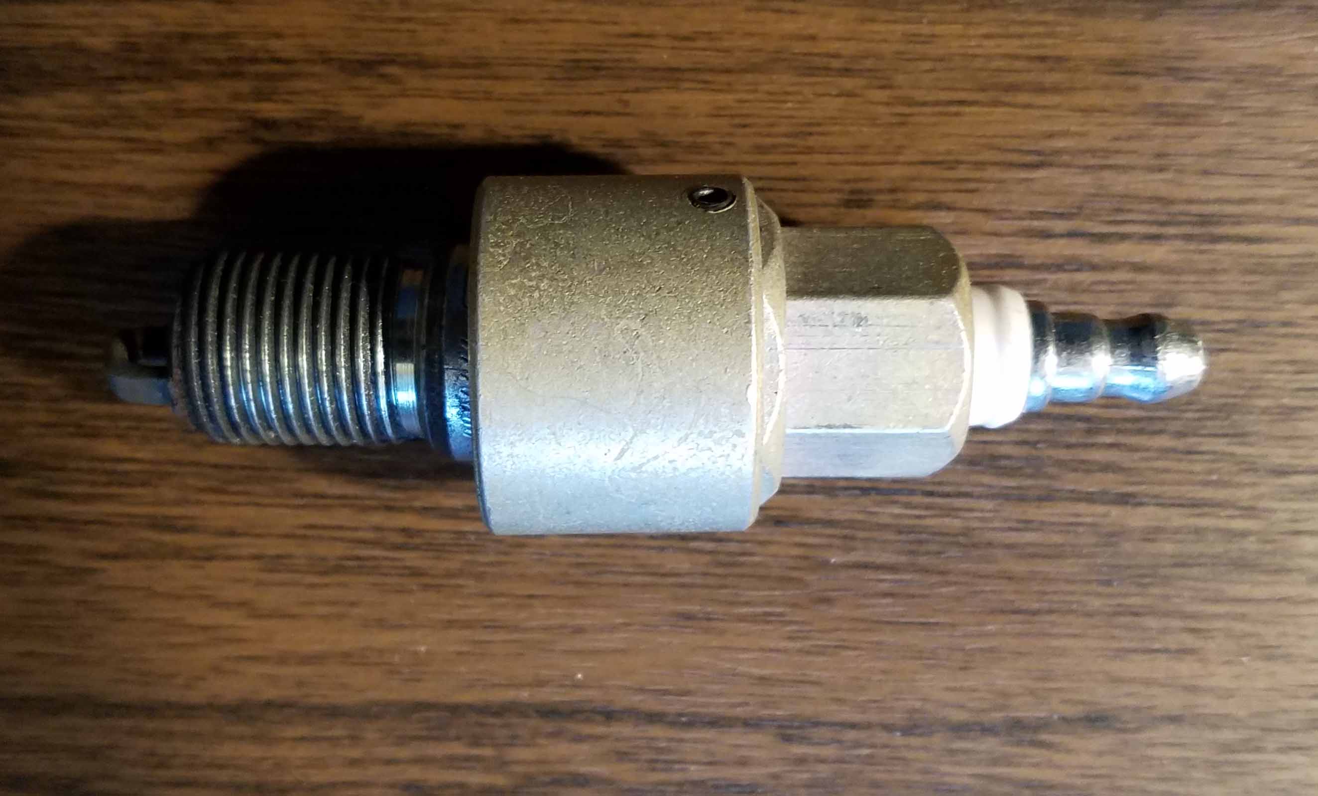

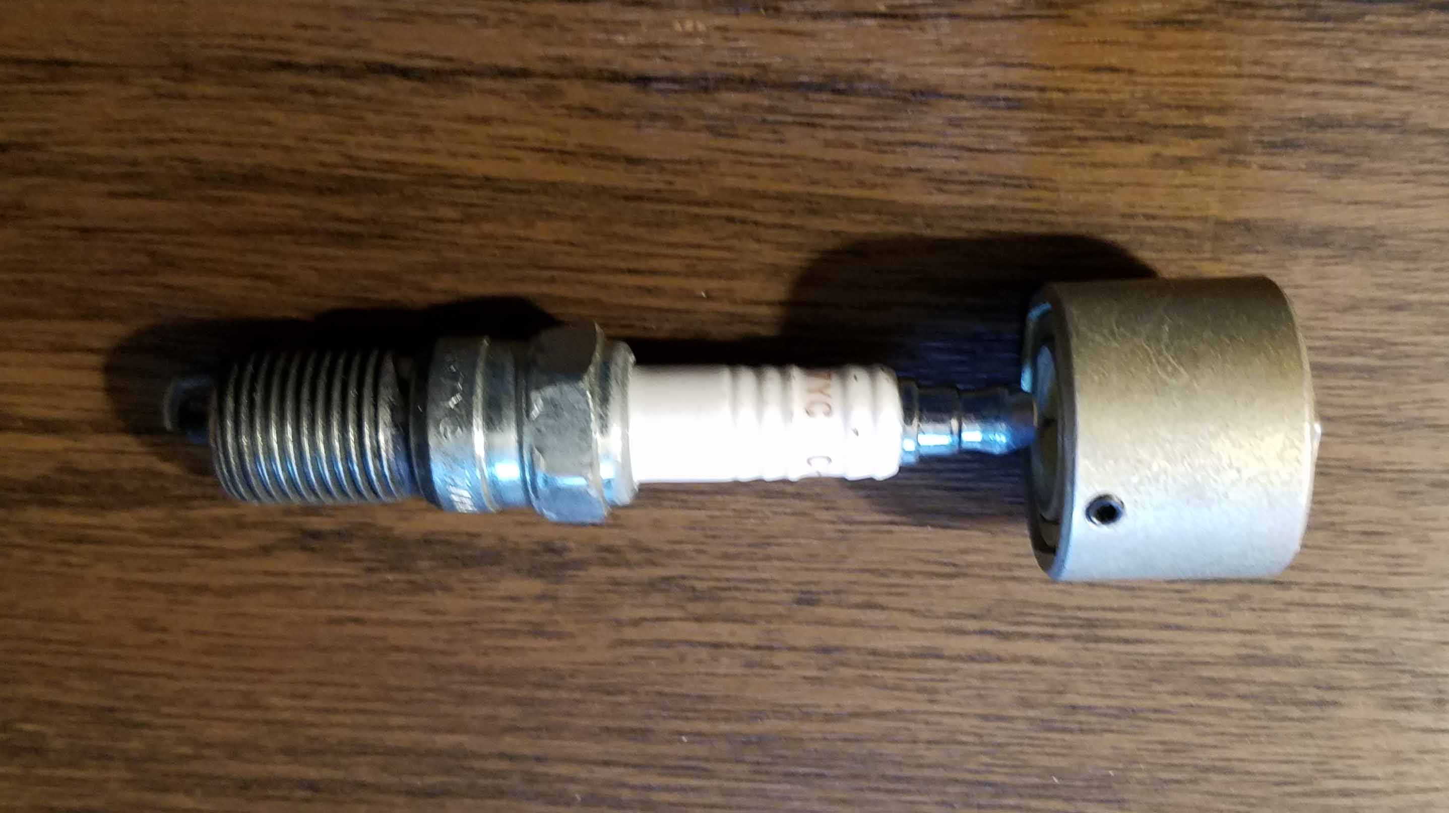

I bought a "collapsing" spark plug socket 20+ years ago. Needs only 3/4" clearance between tip of plug and obstruction (e.g. manifold). Works with both 5/8" and 13/16" plugs. Useful for some of the LT1 plugs, stock manifolds or headers.

They still make that tool?

I can't remember where I bought it - maybe Griot's Garage, online.
