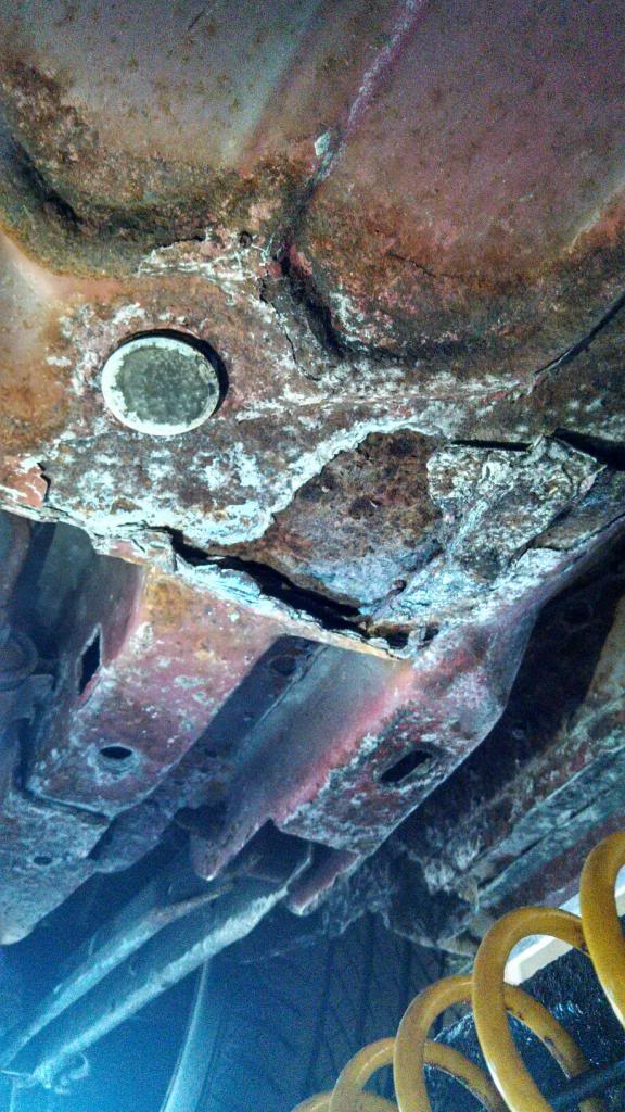

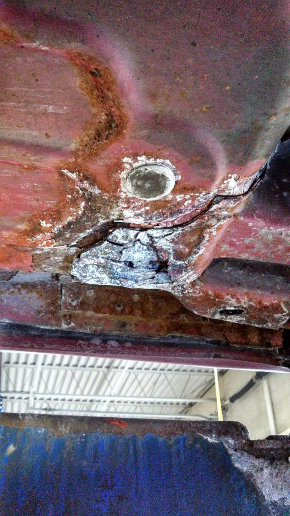

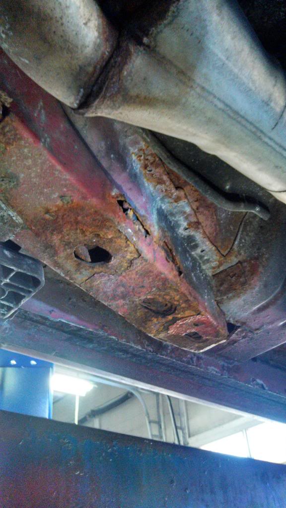

That car looks to be headed for structural failure. There is bad decay in some high stress areas (like in front of the rear control arms, plus the front subframe structure). If the drivetrain is good, I would be looking for another body. Repair for that would be major and expensive.

The shop is correct. That's a disaster. I'd write it off. Is this a snow belt car that's lived it's life in heavy salt?

You must have good metal to attach sub frame connectors to. You don't seem to have much in that department. Honestly, that car looks unsafe.

Subframe connectors will probably speed up the destruction. A bump in the front suspension will pull at the subframe connectors, putting stress on the already rotted connection between the rear LCA subframe and the chassis. From an engineering point of view, there is nothing you can do.
Given the absolute unsafe condition of the vehicle, you may have recourse, even if you bought it "as is". Check with an attorney.
