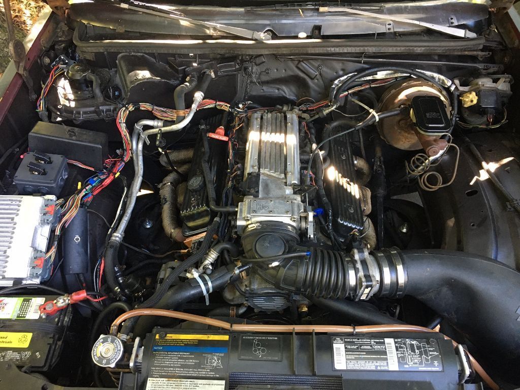

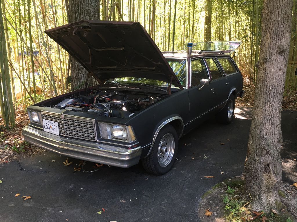

A while back as a father son team we bought a wrecked 1994 Z28 with LT1 and 4L60E. The drivetrain with electronics are now transplanted in a 1979 Malibu wagon. The project is going well.
I'm setting up ALDLdroid screens. On one of the screens I want to list maybe 8 or 10 DTC status indicators for quick reference. In your opinion, what are the most common 10 DTC's that come up on these engines? I can make additional screens if you think the 10 limit is too low.
We still have to tidy up the harness securing and finish split loom install but here's a few pics.

PS: Good looking conversion!

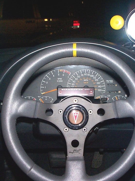

Just some food for thought. One of the most useful scan tools I have used for real time display is the ScanMasterLT1. I purchased that a couple years after I bought my 94 Formula brand new. It taught me more about the workings of the PCM than any other source. Based on that, I developed a document on using the ScanMaster, which I later modified to be more generic. The document is available in this link:

The ScanMaster was useful, in that ihad a single line LED display that could selectively display one or two sensor readings or PCM parameters. Screens were selected by touching a small button on the face of the display. I had this permanently on top of my steering column. One screen displayed all set codes in sequential order, if there were any. Agree it was useful to know immediately exactly what caused the SES light. Note also that there are odes that do not turn on the SES light, including most of the transmission codes. My knowledge of the transmission codes in limited, as my Formula originally was equipped with the T56 6-speed manual.
