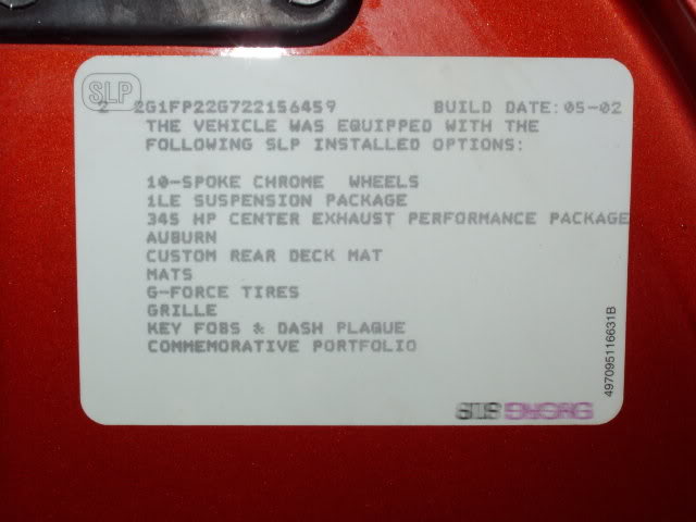

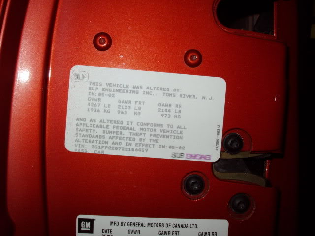

you could look for this sticker on the driver side door
and the SLP options sticker on the passenger side door like this one.
