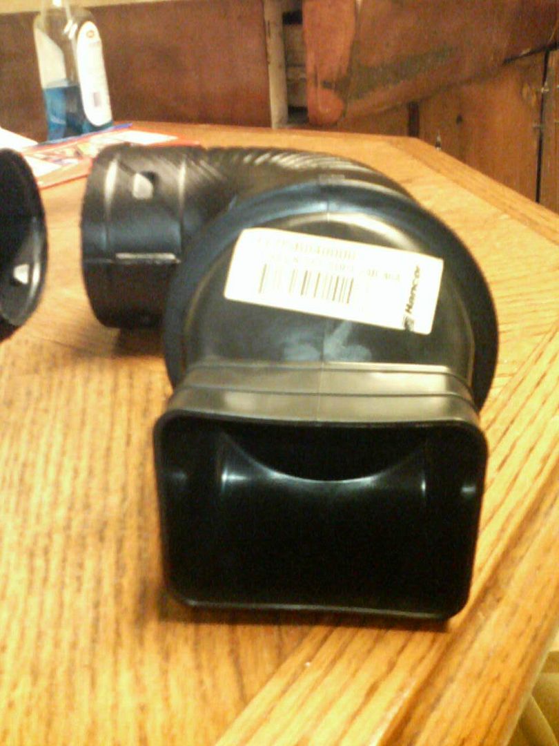

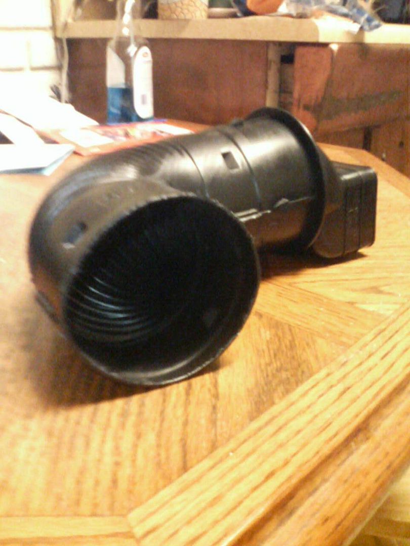

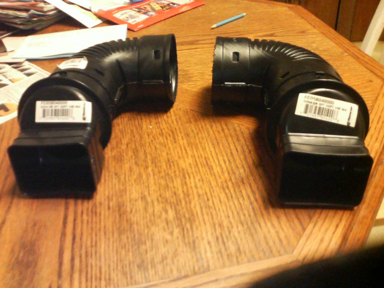

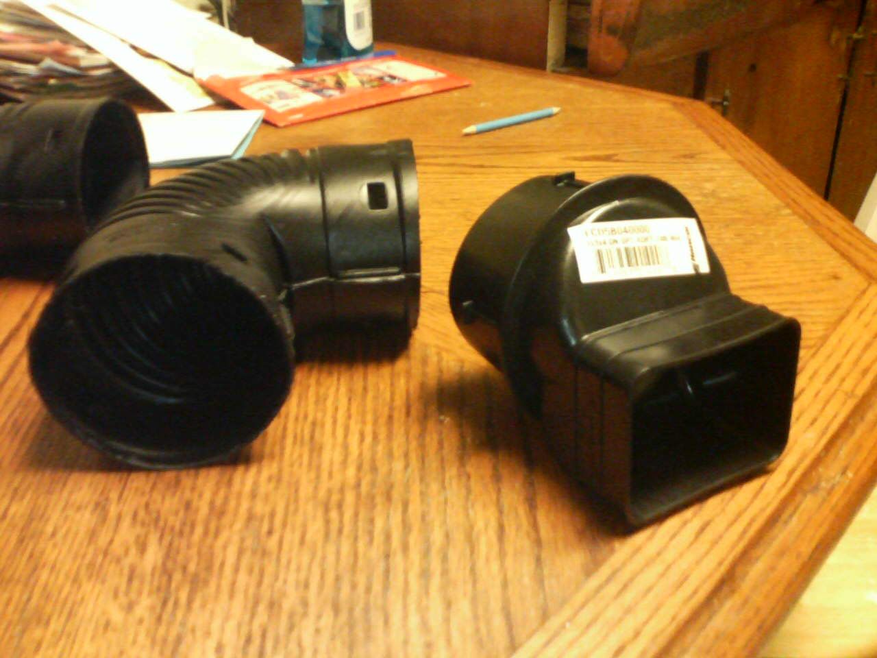

Sorry for the lag. Here's the pieces I bought. I already crammed them in there and they do fit, and they also lead right to the radiator. Like I said, I do not have that plastic baffle piece, i think I removed it when I installed the SSRA a few years back, but you can always just cut out the holes necessary in the baffle if you need. All I need to do now is get off my lazy *** and cut out the foam and dremel the hole a bit bigger.
If you notice, you can see that the inlet part rises up a bit, this helps clear the bumper support that the hole runs into. Also, like I mentioned before, I'm going to cut the 90* piece into more of a 45* shape so that there is a more direct flow to the radiator. I'm going to use tap screws to hold the inlet side down and either use superglue or some plastic bond chemical to hold the two inlet and elbow together.
Sorry for the size
