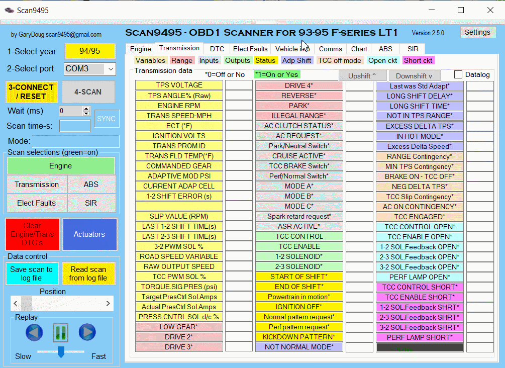

Scan9495 does show the transmission fluid temperature.
Attached Thumbnails Cooling issues always inevitable ?-scan9495-transmission-tab.png
