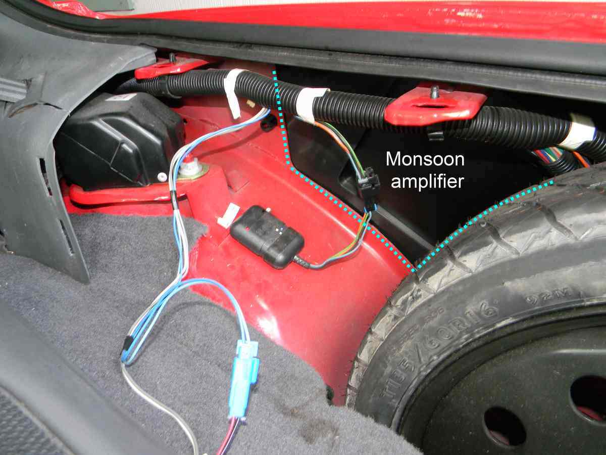

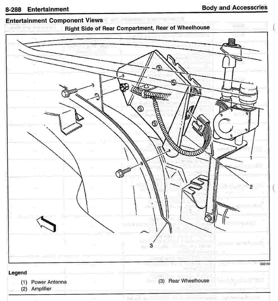

The Monsoon amp was there just above and ahead of the spare. It has a 32-pin connector.

Wow, thanks... I bet that amp is still there then... they just unplugged it. I have no idea why someone would do what they did to the stereo system, in the car.. I think I got my hands full straightening this wiring out...
