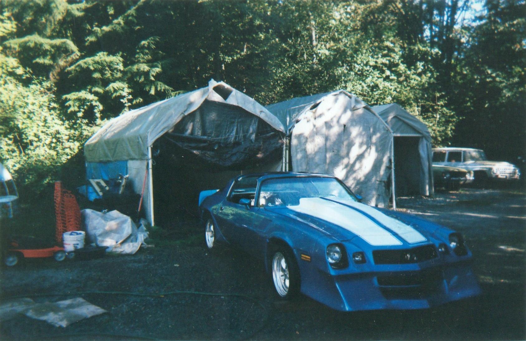

Small block are easy to hop up. There is so much stuff out there for them.It all depends on what you want to do with the car .And your pocket book
Attached Thumbnails 350 SBC upgrade recommendation-130044932860518017_26257430996_o-1-.jpg
