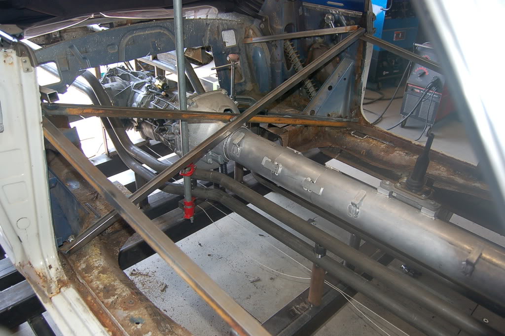

The Corvette Tremec 6060 is nothing like an F-Body T56. It is mounted in the rear of the car, bolted to the front of the differential housing. There is a long driveshaft that turns at engine speeds at all times. The engine and the trans are connected by a large diameter torque tube that contains the driveshaft, and serves as the structural spine of the chassis.
You can make anything work.... just a matter of how deep your pockets are. Here's a guy who installed a Corvette drivetrain in an old Nova:
http://www.lateral-g.net/forums/showthread.php4?t=15838

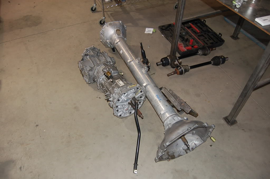

It is made to bolt to the differential. There's no tailshaft housing. How would you manage to attach a driveshaft to it in an F-Body? It doesn't have a shifter on the trans. The shifter is up front sitting on top of the torque tube, and there is a long rod that enters the front of the trans to shift it. How would you attach a shifter in an F-Body.
