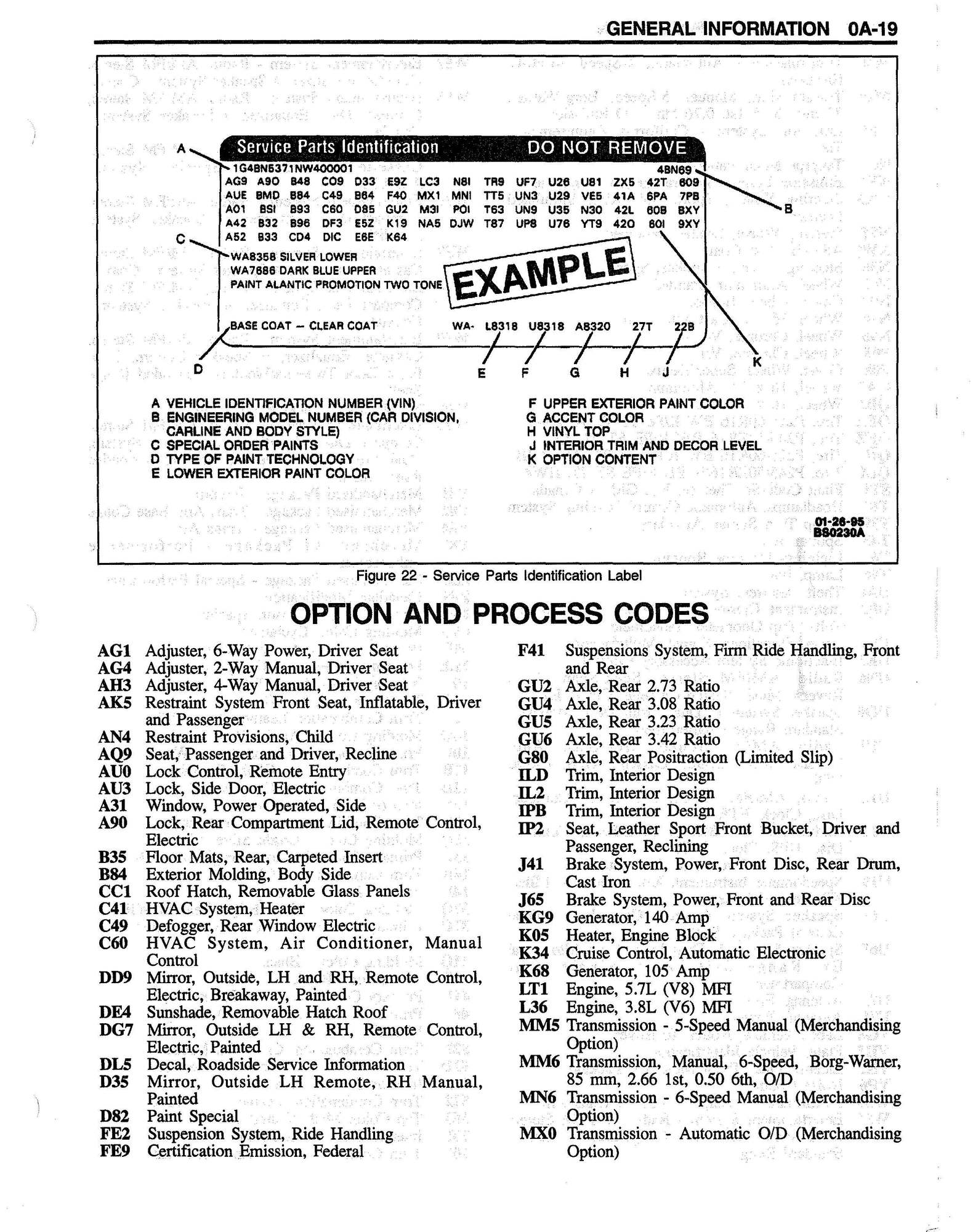

Here are the pages from the 1996 Service Manual that explains what options the RPO's stood for.
