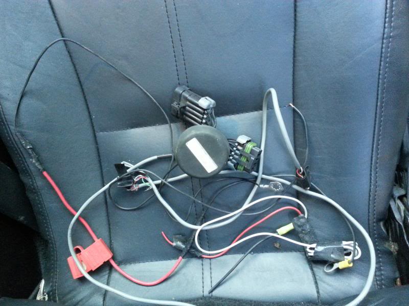

I recently bought a 1996 Z28 from an auction that has a few issues. I've poked around the forum and didn't find exactly the same situation as mine. My ABS and traction control lights are on. I've found that this car has a Hypertech chip and possibly a different rear end gear. It has a Summit Racing cover on the rear diff so I'm assuming there's a different gear in there? I haven't dug in too deep yet. Could a different rear end gear or the hypertech chip be causing these systems to not operate? There is also an SLP brake control package installed. The parts in the brake line are still in place but the wiring and switch were all sitting in the glove box when I got the car. I kind of doubt this is the source of the problem but figured Id mention it.

I'm not aware fo an SLP "brake control package". SLP sold a module that modified the operation of the "ASR OFF" switch. By default, the ASR is active when you start the engine, and can be turned off by using the factory switch. The SLP module reversed the function of the switch - ASR would be off when the engine started, and the factory switch had to be pushed to turn ASR on. That may be what is sitting in the glove box, uninstalled. It would not be causing the "ABS INOP" light, but could possible affect the "ASR OFF" light if the wiring has been altered and the module not installed.
Or, SLP may have offered a "line lock" kit, installing a solenoid in the front brake line, to allow rear wheel burnouts. Is that possibly what you are seeing when you indicate "The parts in the brake line are still in place"?

The car does have traction control. I'm going to double check when I get home but it has the button to turn it on or off. The SLP kit I was referring to is the line lock kit. The solenoid is still installed on the brake lines but nothing else is hooked up to it.
