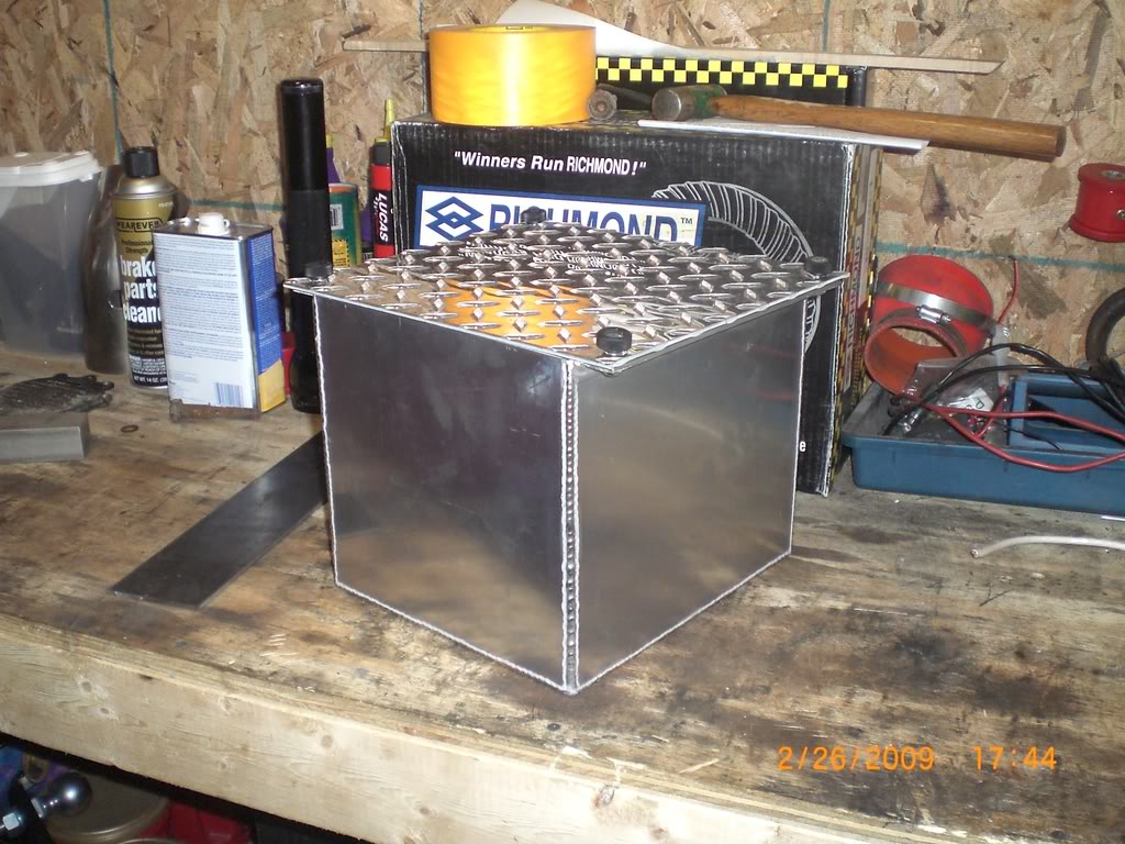

Here is the box I made rather than use the monstrously huge box that summit sells. I wanted the box/battery to be hidden. The box is sealed.

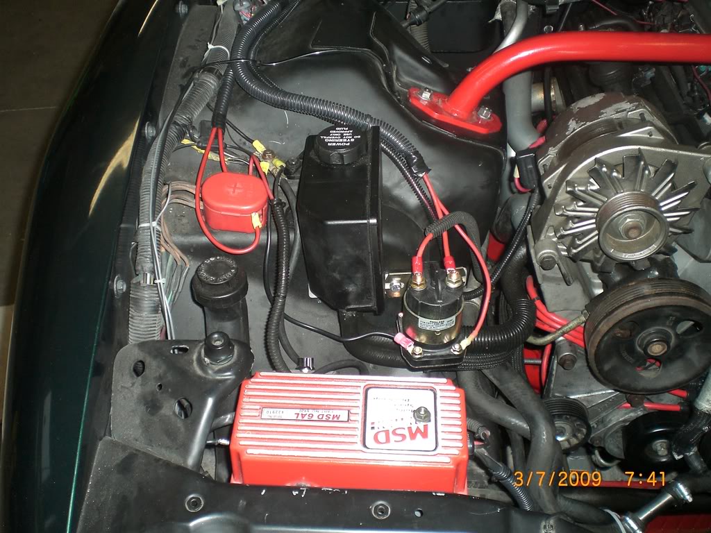

Here is a pic of the alternator kill relay installed:
