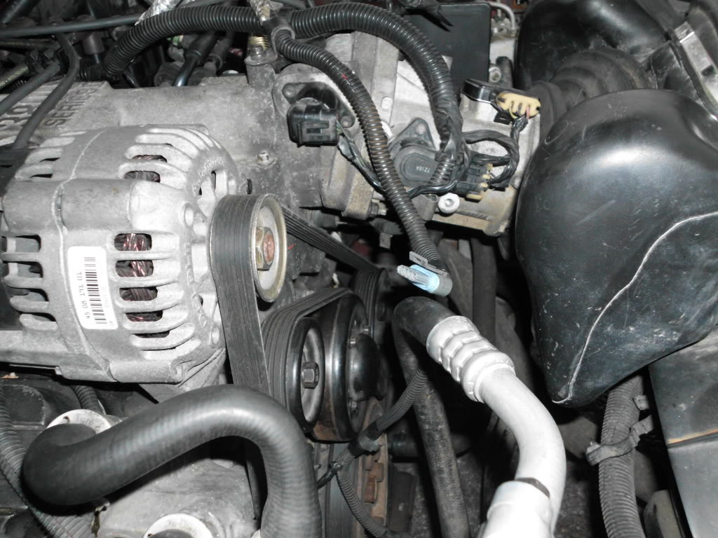

ALSO this thign is really bugging me in the picture i cant find out where it goes to bolt onto and where the little line fits onto.

Also there is a sensor i cant seem to find a plug for next to the fuel rail. and here is the picture
thats on the passenger side next to the fuel rail maybe that has somthign to do with it.... I have no clue where that goes into and its a short wire so it cant be that far from there

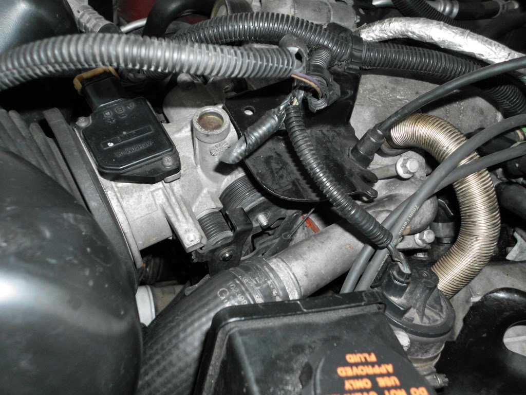

Engine BAY TOP RIGHT next to fuel line IS THE PART I DONT KNOW WHERE IT BOLTS ON TO
there is a close up of same part

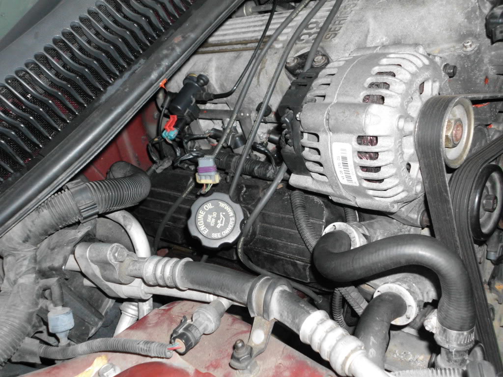

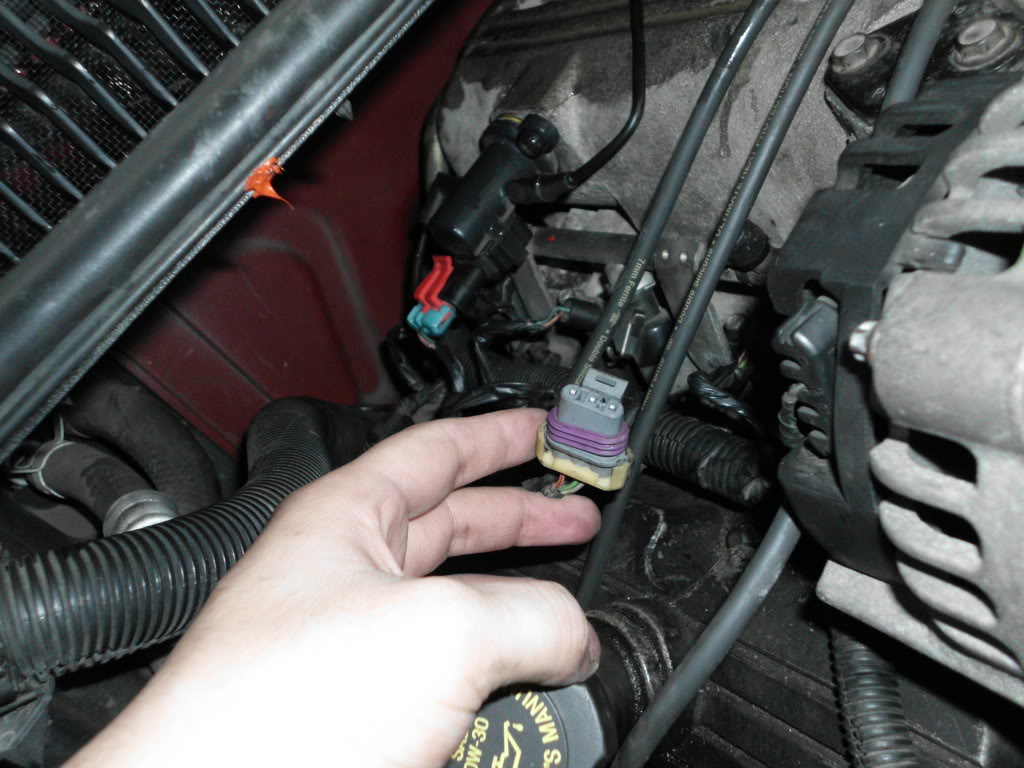

passenger side purple sensor i cant find where it goes
Another picture of thesame sensor close up
Throtle body i know is not hooked up correctly
front of engine the blue sensor i cant find a plug for it

So i Noticed I done test There IS gas in the head i took out spark plug and smelled gas on tip i test plug there is no spark when i turn over the engine so im guess i have a unplugged sensor, crank or cam i know for sure the sensor with the purple ring is unplugged that i see other then that the baby blue one is the oil sensor.
