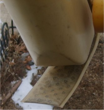

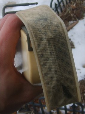

Well, here it is, guys! My filthy, sediment-filled, "needed-to-be-flushed", corroded fuel tank:
TA-DA!!!!
And here's the filter sock:
Just FYI, there's two black spots on the filter sock, but those weren't there when I pulled it out. I sat the assembly on my dirty garage floor to go grab my digital camera...
Oh, in case you're wondering in the 4th picture down, that's just discolored plastic back there. I reached in there and tried touching/scratching it...

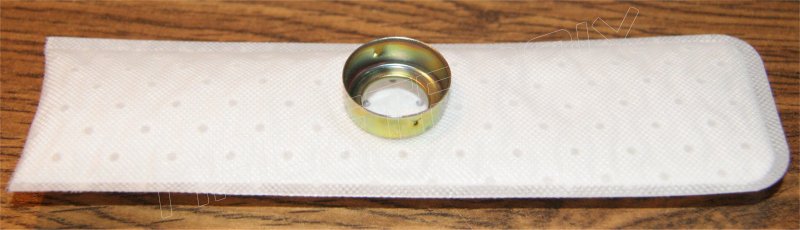

We are very sorry you feel that we are trying to pull a fast one on you. The technical information we have provided is valid and any well-trained mechanic will tell you to always clean a fuel system before installing a new fuel pump or injectors. This is covered in GM's training manuals and is mentioned in some service manuals and bulletins. Contamination is one of the number one reasons Walbro killed their warranty program back in March 2004. Too many people without technical insight where experiencing pump problems and trying to claim warranty.
Sediment is not always visible to the human eye because the dilution can be quite high. Looking down into your tank will not tell you much as it can be like trying to see sugar in water. Particles can be as fine as a grain of sugar and suspended in the fuel as well as settled underneath the baffling in the tank. Some types of contamination dissolve in gas. There is also water contamination caused by a poor tank gasket or cap which can cause parts to rust. Contamination leading to failure is a cumulative thing which takes time. Since the filter sock, pump's magnets and fuel filter constantly have fuel circulating through them, much of what may be in or being put into your tank is being captured in these items eventually leading to problems.
Seeing your filter sock does raise some serious questions as the internal media is VERY black and not the typical light gray or tan associated with long-term gas use. Considering the filter socks are snow-white when new there is much buildup in yours:
These are 30 micron graded-media filter socks approved by Walbro. As you step down through the sock's layers it filters down to a smaller particle size. We can see that your sock is deeply embedded with some sort of black contaminant:
If you say there is no contamination in your system then maybe you should ask yourself how is the filter media filling up with black residue? Perhaps there are some rubber lines breaking down. Perhaps the gas station you frequent has dirty in-ground tanks and your pumping junk into your tank? There is ALWAYS an explanation as to why a pump failed given the right technical training and tools to isolate the cause of failure. Call it pump CSI if you will...
Racetronix is always willing to help customers who are open minded and co-operative. Attacking us on the forums does not help a customer obtain resolution to a problem nor will it alter Walbro or Racetronix warranty policies and procedures. In many cases Racetronix has replaced pumps out of our own pocket even when it was blatantly obvious that customer error was involved. We sell 1000's of fuel systems every year and 99.9% of them work problem free so there should be no reason why yours can not be the same given the right insight into your problem.
If you are willing to contact support@racetronix.com we are always willing to consider a warranty claim even if it is out of the warranty period. We must be given a fair chance to review the situation and product before honoring a claim.

The proper filter sock shown above comes with our kit.
First, I don't think you're trying to "pull a fast one" with me. I do, however, think your claims that "sediment" is the cause of my pump's failure may be false. You may be right, about the GM manuals, but I don't think that "contamination" is always the case. I'm sure you are right in many cases, but I just don't see how it could be with this one. Bear in mind, that not only is the pump only 1.5 years old, but the Camaro it was in is a "weekend-only" car. I MAYBE have put 6000-8000 miles on this pump.
Well, not only did I look in there, but I reached in there and ran my hand across the tank's interior surface...smooth as glass. You say contaminants can dissolve in water? Then how would it cause pump failure? Excuse my ignorance, as I'm not an expert in this area, but I was under the impression that UNDISSOLVED particles is what typically would cause clogging and whatnot, leading to pump failure. I mean, why else would there be an inline fuel filter anyways? You make a fuel pump sound so delicate and sensitive, however, if it were the case, then why even have a secondary, inline fuel filter? I mean, if these tiny, "dissolved" particles can clog the pump, then why even have a filter on the fuel line? I mean, if the pump were that sensitive, wouldn't these damaging particles never make it to that inline fuel filter??
Black residue? Hold on, let me take some pictures for you of the sock as it sits currently (dry). I even took the liberty to dissect the sock for you, so you can see for yourself. Please, show me this "black residue" (in the 1st photo, the dark spot is oil from when I sat the pump assembly on my dirty garage floor):
Maybe I'm off, but it appears tannish, if not light grey, like you described typical "used" filter socks to be... I don't see how it could be rubber...the only rubber in the LT1's fuel system (to my knowledge) are the main fuel hoses, and due to an accident (one was cut), I had just replaced those around the same time I replaced the pump. The fuel injectors are only 3 years old, and the adjustable fuel pressure regulator is 3 years old, also. The rubber seal for the pump didn't look worn, aged, or deteriorated, either. I wished I knew if it was a specific gas station or not, but I stop at whichever gas station is closest (and has 91 to 93 octane) when I need gas. You may be right. I know, there has to be an explanation for premature failure (technically, it hasn't completely "failed" yet, but it is displaying symptoms that it's likely on its way out...)
You're right, I was out of line with my posts, and I do apologize. You must understand, I typed those posts up immediately after removing the pump and examining the tank. I'm sure you can imagine the frustration I had, since I've been asking around online and in my local area about how to flush a tank and talking about it being the cause of my pump failure, yet no one really could give me a clear answer. I've been waiting to change the pump for a few weeks now, and I was expecting the worst when I looked in there. After seeing it looked clean and new...well, you can imagine the frustration I was experiencing at that point. It wasn't my goal either get it warrantied; I was just venting because I was frustrated with the whole ordeal.
Honestly, I don't expect you to consider or honor a warranty claim, as that would be going above and beyond what I would expect from your business, but of course, I wouldn't pass up the offer if it wasn't my fault, either. I'm sure you'll give me the details after I contact you, but I'm assuming you'll want the pump sent to you for examination, correct? If so, no problem at all. Honestly, I really want to know what the cause was, so that you, I, and everyone else here will know whether my claim was true, or whether it was clearly my error; and if the latter ends up being the case, I most certainly owe you a formal and public apology. I do thank you for being understanding and civil with this situation...
