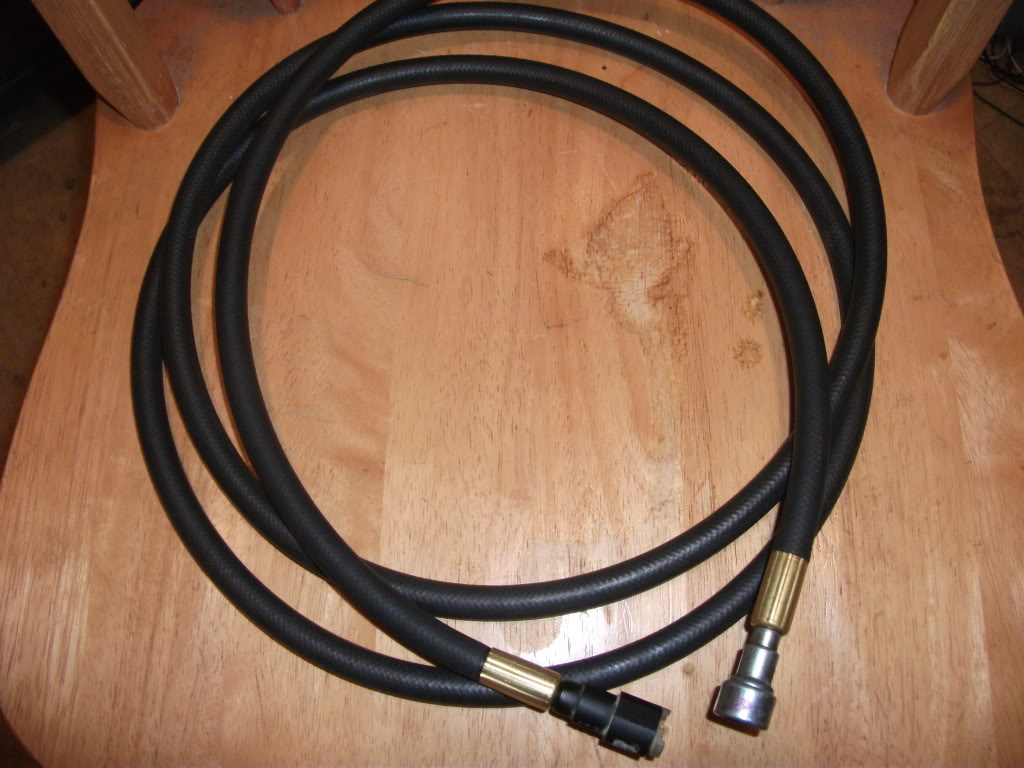

Thanks for your hep, I went a different route though and had a hose guy make me new lines. He used 300psi lines with (I believe hydraulic band crimps) to secure the hose to my original fittings.
here is what he came up with to rid my car of the plastic lines. I highly doubt I will have a problem anytime soon with this setup. Image some day you open your hood and see fuel spraying on of all things the coilpacks. Makes you think doesn't it!
