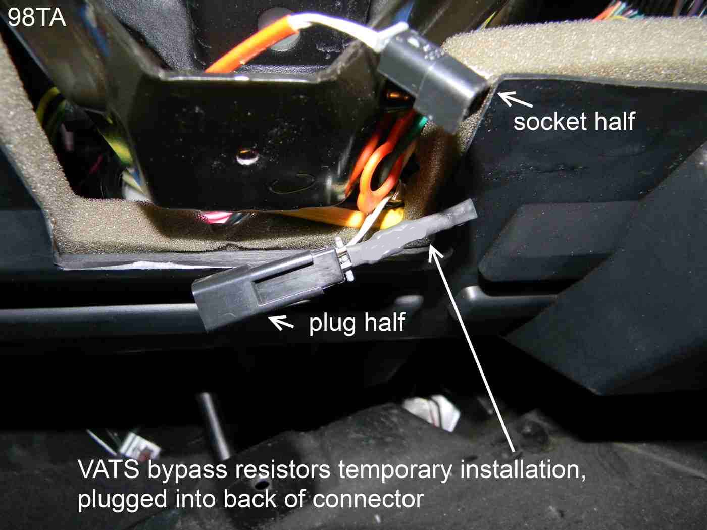

Or maybe you could just prepare in advance by making or buying the resistor device and keeping it in the car somewhere, like I have done. There is nothing to program in the cylinder. You may be thinking of a newer car.
Attached Thumbnails 0.00 switch repair.-vats-bypass-temporary-installation.jpg

I will try to explain this again. The body control module reads the resistor value in the key via the contacts in the key cylinder. If it doesn't read the correct resistance, it turns on the Security lamp (after it normally shuts off), cuts off the circuit to the starter solenoid via the theft deterrent relay, and tells the pcm to not pulse the fuel injectors. If the BCM instead reads an open circuit while the engine is already running, it flashes the Security lamp and disables the anti-theft system so it can be started the next time. The thinking there is that the key worked once to start the car, so it must be a circuit failure.
So you see, just running a switch and wire to the solenoid only fixes the starter issue, not the injectors issue. If you are seeing the Security lamp on way after it normally shuts off a few seconds after the key is turned to Run, the resistor isn't being read correctly. Replace the cylinder and wiring, or install a substitute resistor into the unplugged connector under the steering column to bypass the key's resistor. It can be permanently attached or temporarily like in my photo. If the Security light turns off a few seconds after the ignition is switched on, that key/resistor isn't the problem. Look elsewhere.
