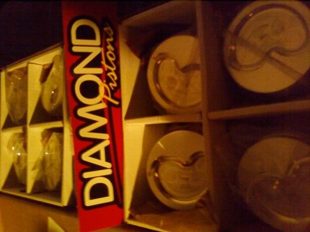

This is what I have
3.480 4340 crank
5.7" H beam rods
-22cc Dished Diamond Pistons (Part # 11420)
Many factors come into the CR part so I cant tell you what it will be. I am aiming for 9:0.1 or something near that.
