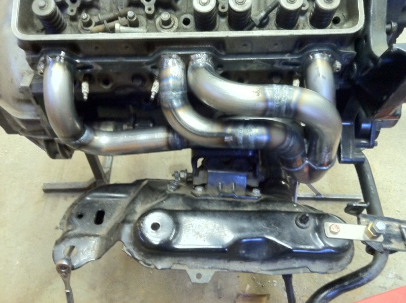

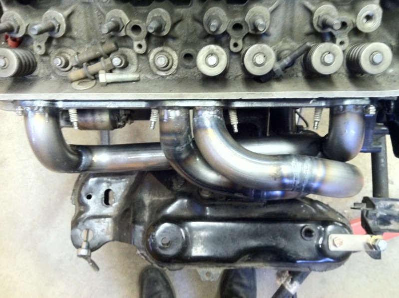

Quick pics...
Mock up of pass side:

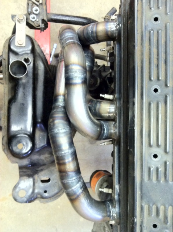

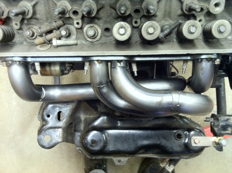

Driver's side:

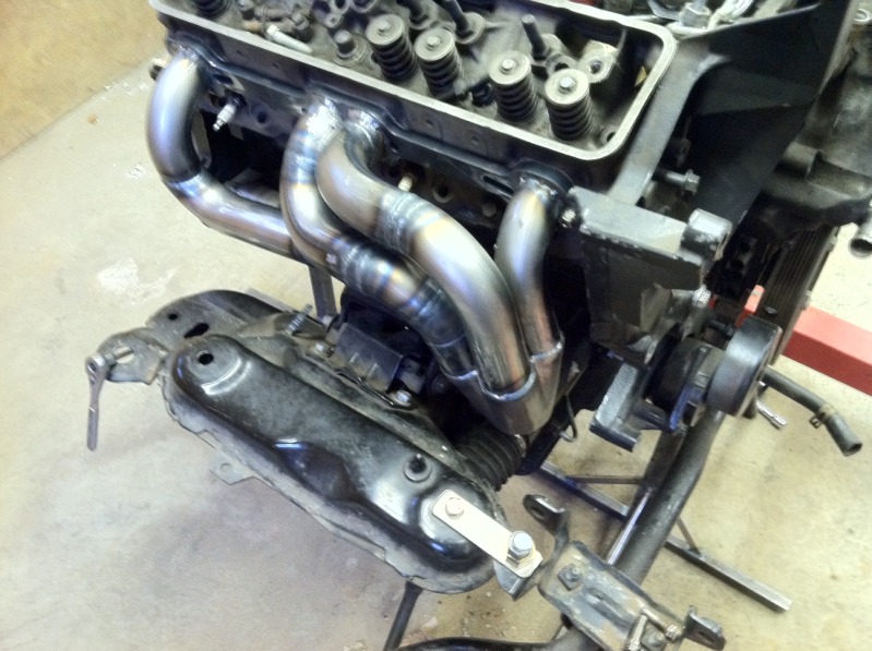

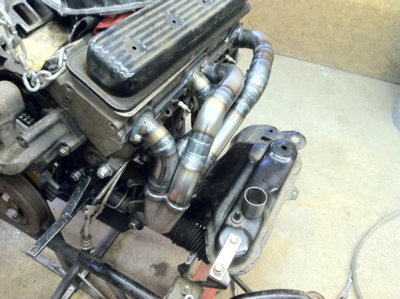

Thanks!

Just registered in this forum today.
I would like to thank Jon for the awesome work and headers he fabbed for us.
Can't wait to install them and test them. Hopefully our goal should be reached.
The motor is being built by Karl Ellwein as we speak.. Here is the link:
ERE-383 #39 short block for customer in Bahrain
Just to share the setup with all the members.. The motor will have AFR heads 1057, Super Vic intake, Accel Gen 7 ECU, reving up to 7k. It is going to be boosted with a Precision 76mm turbo, billet wheel, .96 A/R. Goal is 800-850whp on 100+ octane.
We are planning no more than 10-12 psi on pump gas, and 18-20 psi on race gas or pump+meth.
Thanks
