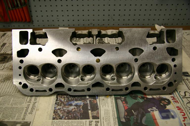

I'm going to make some phone calls and find out. I've been searching on this site and ls1tech for CR calculations and such and the dished Mahle pistons offered won't work for me unless I go with different heads (ie. TrickFlow) with a 64cc chamber. I would think Mahle could come up with something but maybe not!
The guy at Flatlander Racing says it would have to be a custom piston to work with the small CC on our LT1 heads. I see that JE offers a -26cc dish piston flow boost application but it looks like that would only put my CR at 9.4 which seems to be on the high side. Do you have any piston recommendations?

for a 355 with stock heads you only need 26cc dish to get down to 9.0:1 you can use thicker gaskets and open the combustion chambers up some if you have to.

The dish volume quoted from Flatlander Racing's site differ slightly from the volume on jepistons.com. After looking there, I CAN get a -26cc in the JE and a -24cc in an SRP which would put me closer to 9:1. I plan on getting a valve job and having something "fly cut" (my engine builder used that term???) He said that would take out enough material to up the cc in the combustion chamber and help lower compression.
