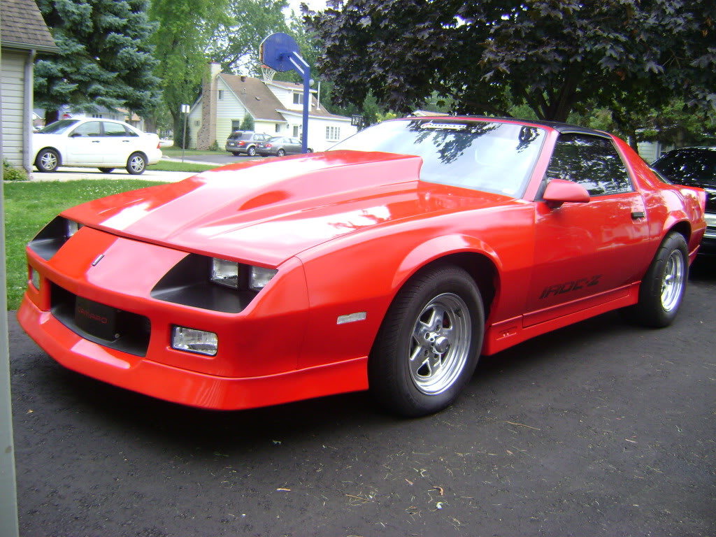

Well I never did make a thread here when I sold the LT1 parts off and bought the 2001 LQ4 and started building it!
Here are some pics!
2001 LQ4
Callies 6.125 H-Beams
Wiesco -11CC Pistons
Stock Crank
Speed Inc/Comp 236/236 112.5LSA Cam
Stock Heads Patriot springs (i did some clean up and small porting myself)
Edlebrock Victor JR
Fast 1375 CFM 4bb Throttle body
ARP Head/Main studs
JP Double Roller timing chain
Melling Hi-flow pump
LS7 Lifters
60# Siemens injectors
Twin 255 pumps
-8an feed/ return
Trans/drivetrain
Built TH400
Reverse Manual Valve Body
TCI 3600 Stall
B&N Ratchet Shifter
Custom 3.00 Driveshaft
Moser 9inch
3.00 Gear Spool
Power adder(s) setup
1 3/4 Forward facing headers 1/2 flanges (i made the flanges and headers)
2.5inch Crossover
4-3.5inch Down pipe (fender exit for now)
50mm Synapse Wastegate
Garrett 74MM T6 flange turbo
50mm BOV
31x12x3 Intercooler
Extreme Velocity O-ringed Carb hat
Snow Performance Dual nozzle meth kit
Dry Nitrous Plate kit (not finished will be for next season)
Here are some pics now! I had to add the cowl for clearence as much as I didnt wanna, I also painted the front clip in my garage for my first time!
Jay

very nice car man, that looks great, and those headers look awesome! id be interested to find out some numbers tho

Similiar to my buddies 9 second 3rd gen except he's on a stock shortblock 6.0, otherwise the mods are real close. Should be a FAST ride!
