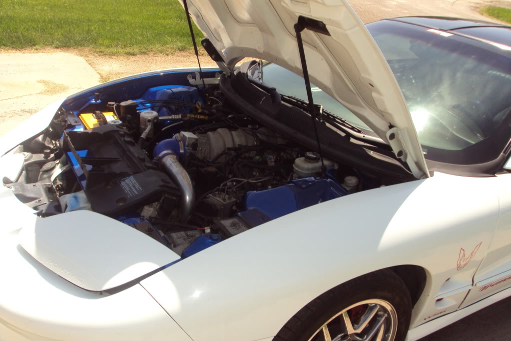

Alot of mods already done. I found the car for him blown up. He paid for the sts kit and thats about it. I have the engine bay gutted with a fresh paint job on it of electric blue. He is repainting the entire car.
Engine setup is gonna be
6.0 Iron Block
Z06 Cam
Patriot Dual Springs
Other than that stock bottom end.
With the LS1 in the car on 8 psi it made 480hp and 540tq

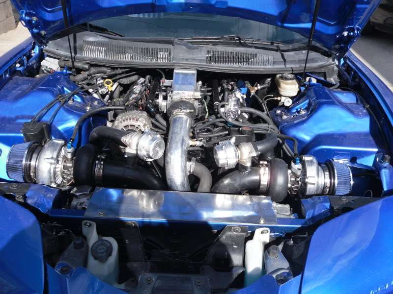

NOW
Fully Built 370 Iron Block
Built 6 Speed
9 inch
Twin 64 MM
Goal is 800hp with ac
I also have a lsx twin turbo nova thats mine Ill be starting on really soon.
Here is some progress. Got some done this weekend.
Twin MP64s
Drivers
Passenger
Tig welding takes forever LOL

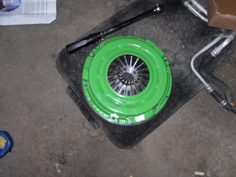

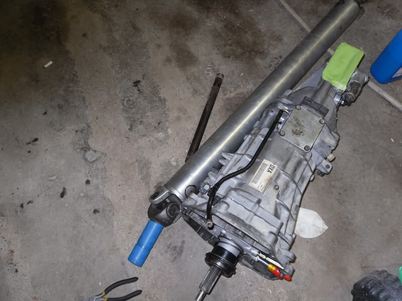

tick level 3 viper mainshaft cyro treated
Monster Level 6
Decent pic everything is still finger printed up
Yes the gates are recirced into the down pipe. I dont like the open gate noise.
