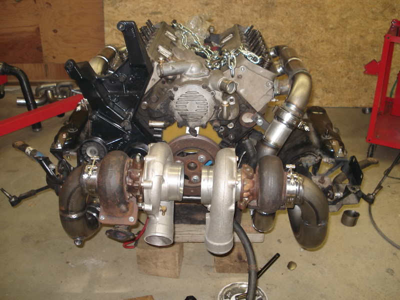

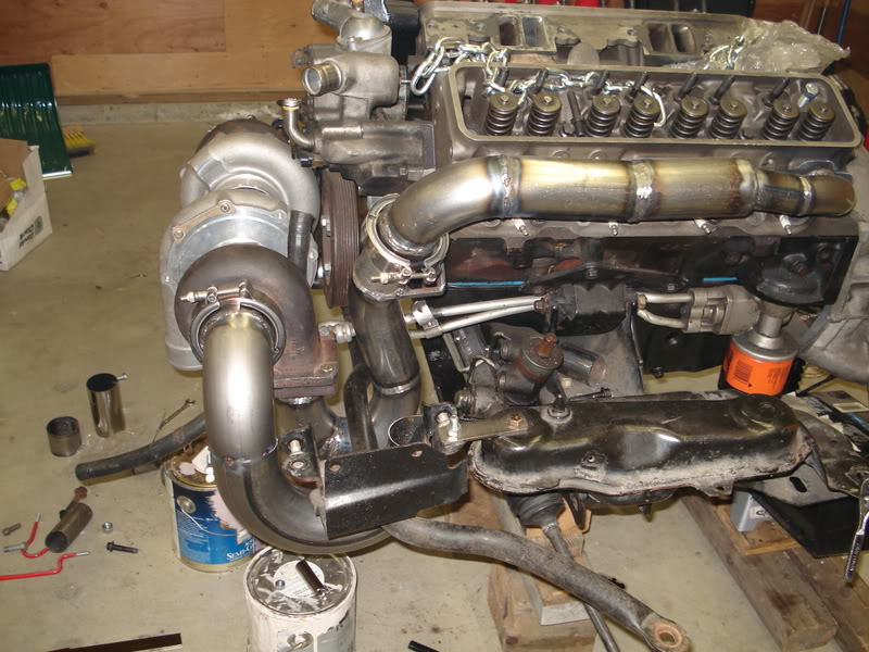

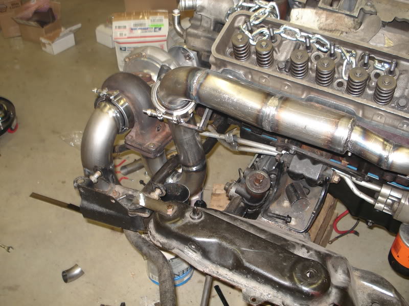

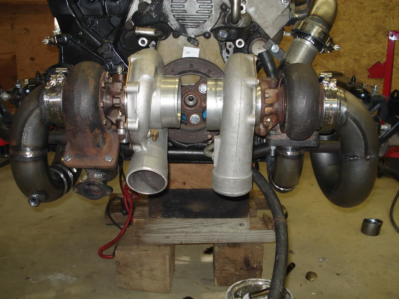

Some updated pics:

so looks like it will be a no-filter screen-only kit?
What if you turned the turbos around and had the two 3" connect into like a single 4" downpipe?

yeah, screen only.
the next one I will try and design a filter setup (so rearranging the turbos like you mentioned).

john, i dont think it'd be too hard to do from where your at.
Try putting the left turbo on the right so the screen would be facing the wheel wells. It should fit without much problem, and without much extra work.
I know as a customer, it'd make me happier if I had one with filters, especially on a street car.

i'll look into it for the next kit, thanks for the advice!

Instead of taking the downpipes down under the sway bar could you not turn them 90* and parallell them over top of it?

it wont clear the A/C delete pulley on the pass.side, so i wanted to make the DP'd look the same... so i copied it on the driver's side.

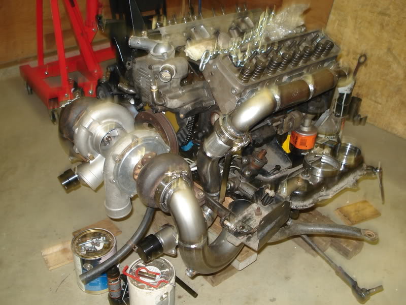

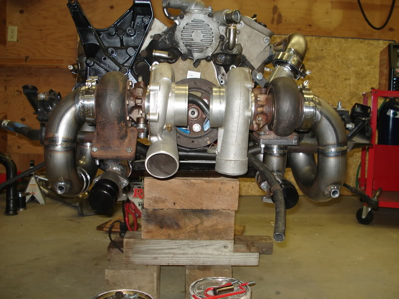

Still need to do some final cleanup:

That looks sick... There's going to be a gap in the time/space continuoum between those two turbos.

Hey, are you using the battery to counterweight the bellhousing?
As a real quick side note, how much weights do your various kits add on to the nose of the car? I'm really curious how all this stuff compares.

are you worried about the air inlets being so close and causing flow issues?
