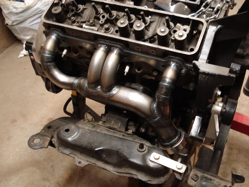

Another build I am starting... customer wants 7-900rwhp capable. I am supplying the hotparts with log manifolds (as the more expensive headers are not needed for that power level). He will be using Masterpower T70's.
Some prelim. pics of the manifolds I am doing:

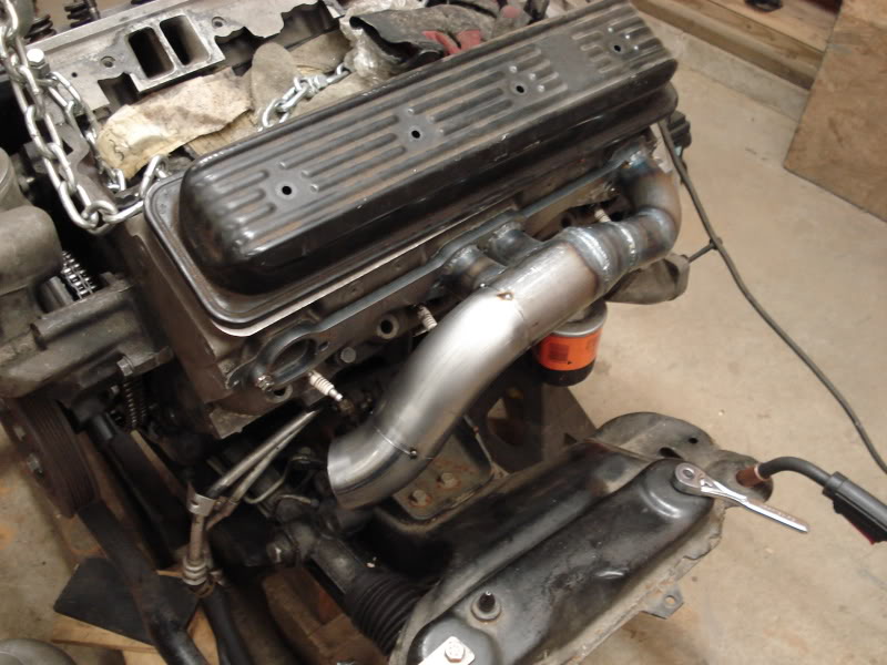

Old Apr 11, 2011 | 12:09 PM
RealQuick's Avatar
Joined: Feb 2002
Posts: 5,645
From: Bridgewater, MA
Re: LT1 Boost TT kit Build
Some pics showing it tacked up. Still need to add wg's and bungs.

Old Apr 11, 2011 | 05:00 PM
Procharged94Lt1's Avatar
Joined: Dec 2005
Posts: 907
Looking good- thats a lot of parts stuffed in a small area- how much room is there from the intakes of the turbos to the frame rails you figure? That would be my concern being able to put filters right on the turbos and not needing more piping for the intake side.
Old Apr 12, 2011 | 08:04 AM
RealQuick's Avatar
Joined: Feb 2002
Posts: 5,645
About 4.5-5 inches. I am thinking a cobra head 90 degree elbow will easily fit. I would recommend that, and then locate the filters in the front fenderwall for cold air.
