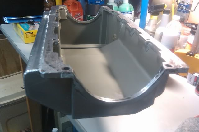

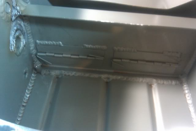

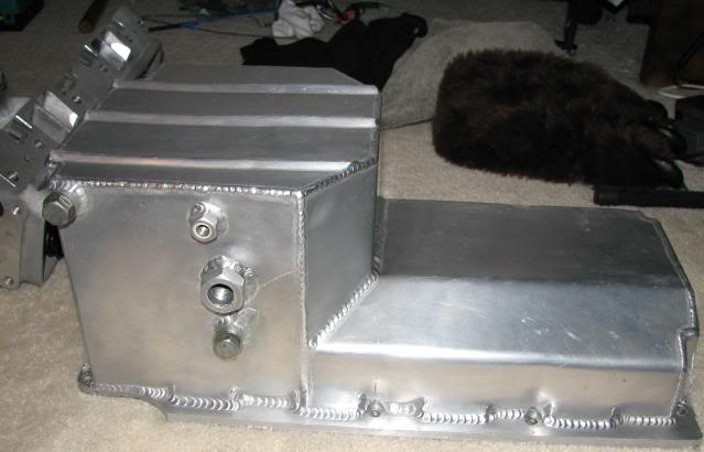

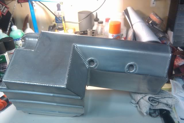

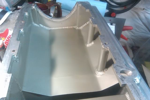

I won't comment on the pan without seeing it. It's usually a better idea to brazen weld the pickup onto the pump so it doesn't fall off. The oil you run should be determined by the clearances in the motor. I like Mobil filters personally but as long as you use a good quality one you should be fine. You probably need to tap the pan for the oil return from the turbo if you haven't done so already.
Here's the pan
Ok so good idea I'll try to reach the engine builder to get specs or at least ask them what motor oil they would recommend running in this application.
Also I have seen some people with turbo setups use scavenge pumps? This is to help circulate the oil to/from the turbo iirc. Will I need one or it depends on the placement of the turbo? I guess I'll speak to Jon about that...

That's a nice pan. You may be able to use that port above the oil level sensor but I'm not 100% certain. Mine is tapped near the front driver side.
