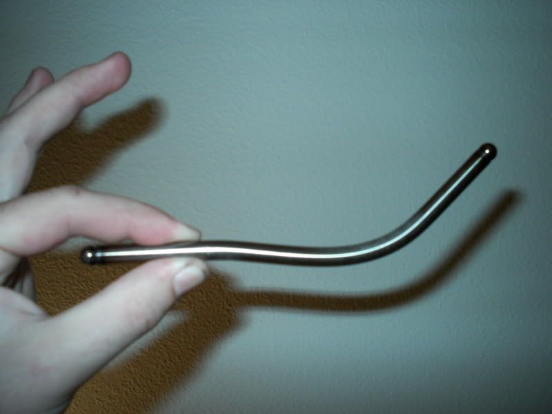

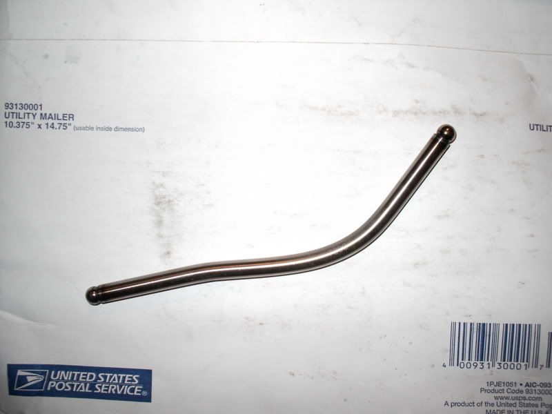

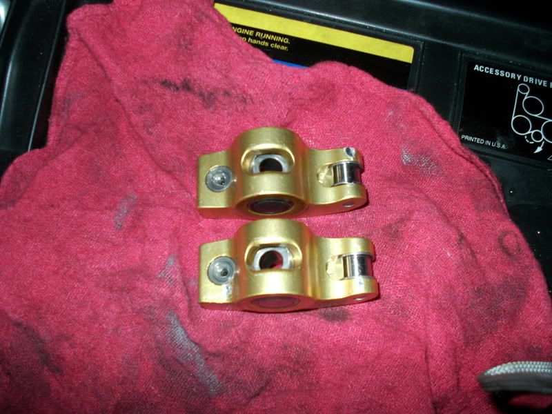

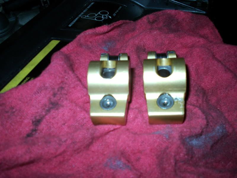

So I put in a new set of TR6s gapped to .035 with no avail. Running out of things to check I pulled the valve cover just to take a look and found no push rods on the #5 cylinder. Apparently one of them bent halfway to a J shape and took out the one next to it. I'm going to call Crane tomorrow to find the correct length for the rods since the 7.2s don't seem to be cutting it. Not sure why 8 wasn't firing, but I'll worry about that after I swap out the push rods. For not checking that the first time.

I've been tearing into the motor the last few days trying to find something that would have caused what happened and haven't found anything wrong. All the lifters are in good shape, the other 15 push rods were in good shape, the head/valves, and pistons are looking perfect. I'm going to run the head over to the machine shop that did the work to have them check the valve guides and see if maybe something went wrong there. At this point I'm just glad a valve didn't punch a hole in my piston. Heres a few pics of what did get damaged.
-Pete-

I forgot to add, the length push rod crane told me to run seemed way off. Considering the heads have been slightly milled I'm just going to get a test spring and measure with a measuring push rod.

should have done that in a frist place all motors are different so you never know what lenght you will need till u actually check it Glad it was just a pushrod, not something major

Sounds like the rocker arm adjuster backed off. I had the exact same problem with one of the first engines I ever built.
