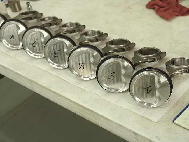

These are the pistons :
http://161.58.59.82/pics/pulling_hea...3/DCP_1836.JPG
For now, I can only guess there size. I want to say -10cc. They are JE SRP pistons from about 2001.
-Alex
Look like my -31cc pistons (or atleast -24cc). Way more than -10cc...

-24cc you think? Wouldn't match up with the setup...my CR would be really low.
4.03 x 3.875, 4.125" gasket bore, .055" gasket thickness, -24cc pistons, 58cc heads (best guess), .005" deck clearance = 9.5:1 CR
The motor is MORE built, so I assume he would shoot for about 11:1. I think -31cc would be a dedicated FI piston. I might have to pull the heads again and measure the deck height, piston area, and heads. Any idea how I can measure the pistons while in the block? Clay and water??
-Alex

There are more pictures in that directory. Here is a close up before I cleaned them with WD-40 :
I want to say they look about half the depth of your pistons, but I'm not sure. Maybe a -15cc is a better guess? When I looked at a JE PDF catalog, they showed there non-FI inverted dish pistons were about -14cc.

If anyone can take a stab at the CC of the pistons above, please let me know!
