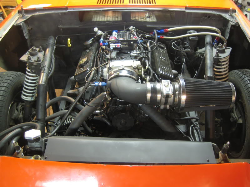

I dyno'd my rx7 a week ago Friday on my nitrous lt1 setup, made 327whp on motor(down 3 cylinders, rings are bad which we already knew), bottle was empty(didn't weigh it before I went to the dyno) and my buddy made 552rwhp on 11lbs in his 5.3/tc78 3rd gen(has been running 14lbs), then he ate the 4l80e tranny on the dyno. I offered him my th400 so he could finish out the year, but he didn't want to do that so he offered me his entire motor/turbo and we would build a new kit for it to fit in my car.
Just a week later, yes only a week, we swapped in the 5.3, built a turbo kit, moved the radiator some, put on a fmic, wired up the 5.3/etc, built a new fuel system with twin pumps, new regulator, etc to support the power/e85, used my th400/converter, got a new driveshaft made, wired in a boost gauge, new wideband(mine died, damn lc1), and all that stuff. After just a week we got it on 11.5lbs, 18 degrees timing(he was running 23 degrees in his car and 14lbs), still just a conservative tune. I'm running a gm boost noid and mbc so I have 5lbs of boost and when I hit the button on my dead pedal I get 11.5lbs. We did a lil racing yesterday, needless to say the car doesn't hook at all anymore. Before with the nitrous(100 shot), and my 2.80 gears, it would dead hook on the spray 30ft out, now on high boost I am spinning at 80mph, mind you this is with a 315/60/15 mt drag radial(basically a 30x13.50)!!!

Here is how it looked before...

And a few build pics...
Originally did no FMIC, ditched this setup after 1/2 a day of driving and stupid high IAT's!
Here is what it looked like in my buddies car...
Mind you, we are just two guys working out of a garage, no lift, nice $$$ tools, etc, just building fast cars. Hopefully I can hit the track this week to get some numbers out of it, should mph nice, not sure it will et all that great.
