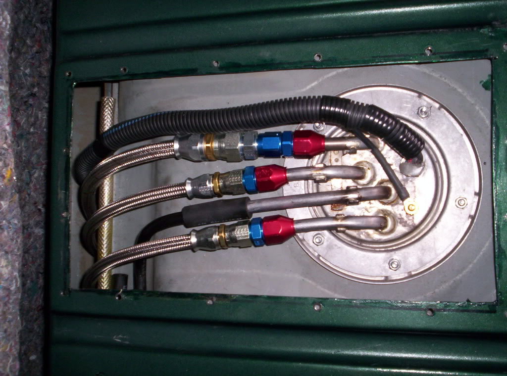

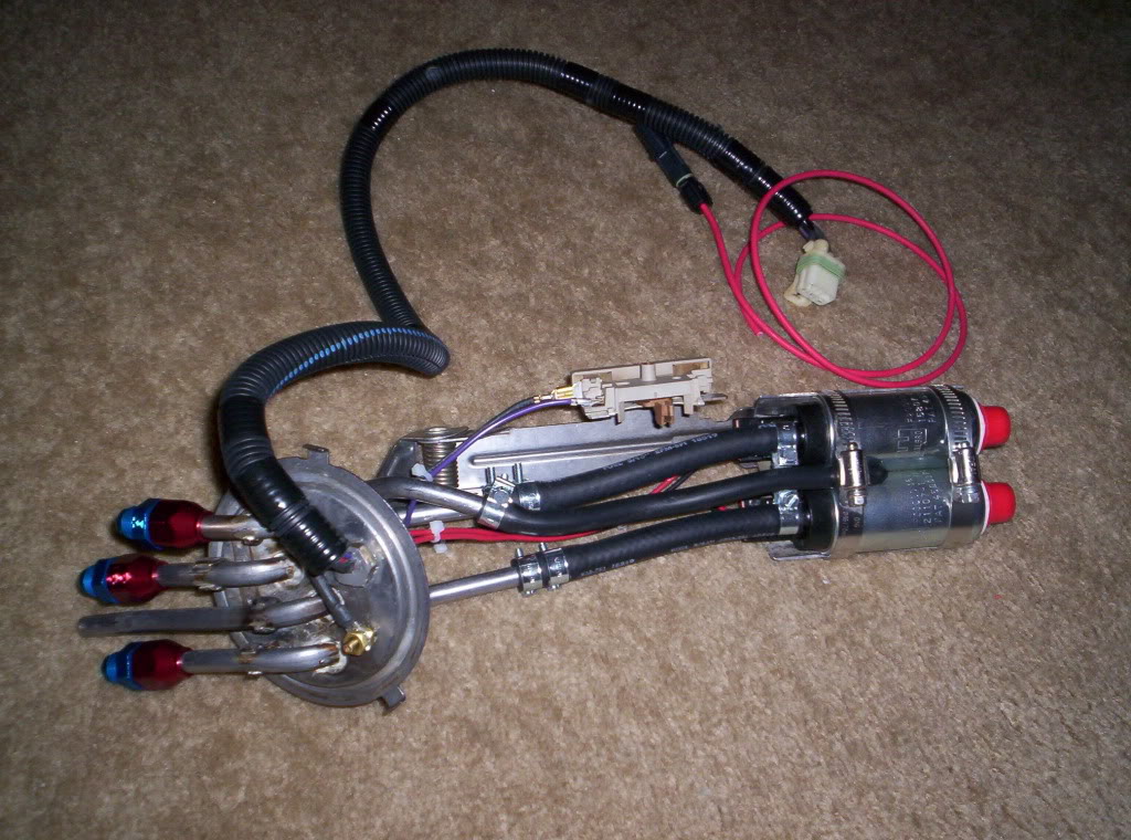

I have two pumps on the sending unit. I reworked the sending unit completely, though. Where others simply tee'd the two pumps together, I redid the hard lines with larger tubing. I ran separate lines out the sender to a filter, then a larger line up front and a Y then to the back of the fuel rails then a magnafuel regulator, then back to the tank. I used some teflon/braided lines. Here's a couple pics of it, anyway. I have more if you ever decide to do something like this. Other guys get along with much less than I have, though. they are using stock lines and just went the twin in-tank pump route.
beautiful job!
I just can't afford the big lines right now, I invisioned the same pump mount and wiring on my sending unit - just using a y-fitting and the stock lines.
Another $110 pump, $60 hotwire kit, $25 Hobbs switch and an afternoon plumbing it onto my existing single pump unit. I will nt get an aftermarket regulator yet based on your replies.
thanks for sharing.
you have the return line just dumping into the tank, yes?
How low have you run the tank on gas and how old/ miles are on the set up?

Originally Posted by chief455
beautiful job!
thanks for sharing.
The return fuel line is that black hose that ends right between the pumps, so it kind of drains over them. It has been up for at least 3 years, but only a few thousand miles. I did set up the pump wiring so that I can switch connectors to make the secondary pump the primary.

so - you just ran your own red wire from second pump - from sending unit to alternator power (or hobbs switch?) - tucked into the same plastic shielding? no second relay or anything??
can you show me how you set up the wiring? that is the third time I've heard switching primary pumps. I have an idea but would like to see if it's easy for you to show - pics or diagram. thanks - you're helping alot.

I put two relays in back, one for each pump. One relay is controlled by the fuel pump relay, the other is controlled by the WOT & manual switch. There are two identical connectors coming from the fuel pumps & the relays, so I can switch them every year or when ever I feel like it.
I completely replaced the stock in-tank wiring so that it doesn't go through that *hitty little yellow connector. I ran 14 ga wires through the sending unit and made a separate large gauge ground which you can see in the pics. I have a big wire feeding the fuel pumps/relays, coming off the alternator.
