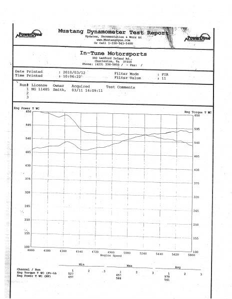

jsetzer: Not sure if the boost is falling off or not. I wasn't able to be there for the dyno tune. I have a print out of the run, but I will have to take it to work to scan it in.
T/A Kid: I am running the new "hat" intake from Procharger. It's the one that replaced the dryer hose kit.
The tuner is a VERY Reputable tuner in this area on several platforms. The dyno graph shows peak HP actually closer to 5700 then gradually declines from there. Peak TQ is at 4100 and steadily falls from there and making 530TQ at 5800. The Dyno is a Mustang Dyno. Not sure why he thinks the cam is limited in the upper range other than he doesn't like the 112LSA on a blower motor.. Car is a beast and easily pulls 40-50mph burnouts on Nitto DR's!!

Mustang dyno is putting your numbers a good 10-20% lower than a dynojet would. So those numbers look purdy good.
If it peaks at 5700 and gradually falls off that may not bee too bad. If it craters that early there is a problem. How high did it pull and what was the hp/tq there? Get that graph up for us.

Dyno Sheet

Can you repost your graph or a link to it? It's not showing up for me.

Wait,,, 600rwhp through an unlocked auto? Go run it down the track. Dyno numbers are dang near worthless on this setup.

I don't understand your statement. I thought you could not lock the converter at WOT? So are you saying my numbers are acutally higher than they would be if you can lock the converter??

Here is some of my input, for the low numbers.
1. Mustang dyno ( you could see another 50rwhp from a dynojet)
2. TQ converter being unlocked, yes you can lock it and I have seen as much as 40-50rwhp from that as well.
3. Blower speed with a 7.65 crank and a 3.4 Blower pulley at 5500rpms is only 50,737 out of the available 62,000 rpms, so you have plenty of blower left, either raise the rpms (when you figure out whats going on) or swap some pulleys.
BTW I like you cam choice, I have a 224/230 with high lift lobes on a 112LSA on my setup. Blowers like a little overlap IMO.
What intake is on the car? Its making the TQ it should in my opinion but, HP is lacking.
