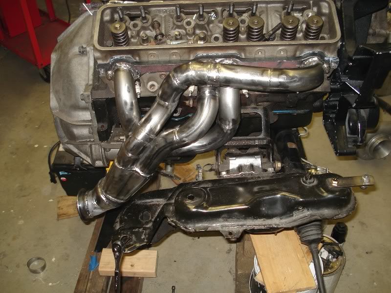

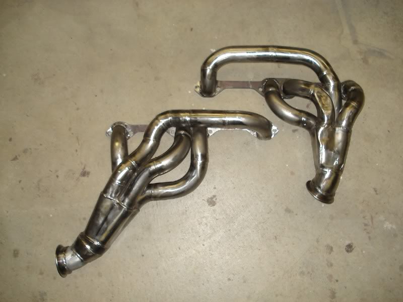

Old Jan 13, 2009 | 09:06 PM
RealQuick's Avatar
Joined: Feb 2002
Posts: 5,645
From: Bridgewater, MA

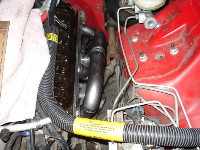

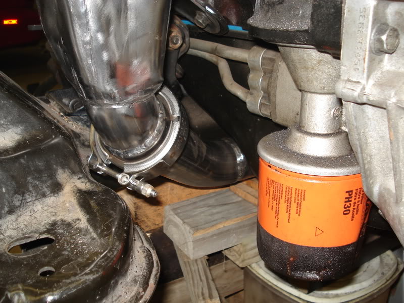

Crossover pipe:

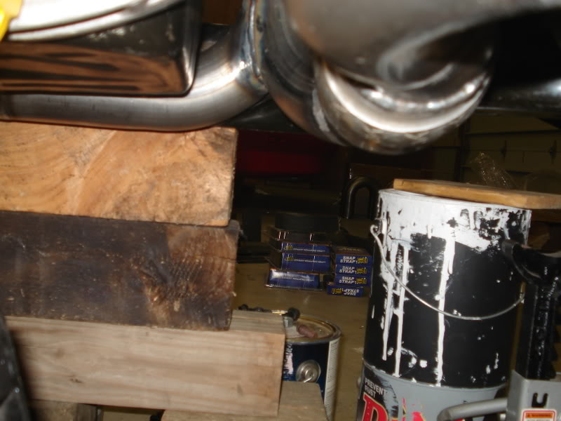

ground clearance:

Originally Posted by RealQuick
Crossover pipe:
ground clearance:
so that goes IN FRONT of the oil pan? never thought of doing one like that. You just opened up a **** ton of ideas for me on my new build
