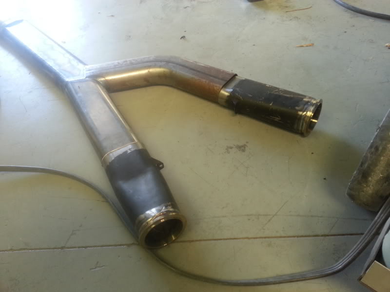

Actually, I'm not just what size based on several sources. I had found a couple of Chevy Muscle Car online info but now I can't find it that mentioned what you were talking about. That was the reasoning for asking in the 1st place, just needed more understanding of it all. Hoping to have something like this when it's all said and done if it is indeed worth doing.
Attached Thumbnails Custom oval y pipe. Pros and Cons?-20130927_112246_zps36c533e5%5B1%5D.jpg

The biggest problem is going to be the transitions from round to oval. Expansions and contractions in the pipe (anything that disturbs flow) results in pressure drop. The transitions from the round collectors to the oval pipe in the picture look good. Not sure about the "Y" point... compare it to the length of the Flowmaster dual 3" into 4" merge.

I'm probably overthinking this. I had the custom 3" Y-pipe in the picture, with 3" Borla XR1 mufflers in place of the cats, through a 4" Mufflex catback. At the 800 (flywheel) HP level, removing the Y-pipe and the catback, and substituting 3" straight pipes/turndowns from the XR1's to in front of the rear axle had not real impact on HP.
If the issue is ground clearance, the oval pipe will have to be placed "high" with the transitions eccentric (top of collector even with top of oval pipe) to keep the bottom of the oval an appreciable distance above the ground. Just use common sense with the fabrication. I've seen oval dual pipes run all the way from the collectors to small mufflers, then under the axle to tips in the normal place at the rear bumper. Didn't seem to be a problem with a 1,000+ HP forced induction LT1.
