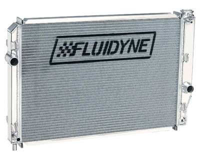

Wondering what all of you are doing in terms of your cooling system. EWP, aftermarket radiator and if so which one (fluidyne, Becool, Griffin, etc) 160 stats, water wetter, straight water or mixtures of both?
I am currently running a EWP w/ a warning kit, 160 stat, 60/40 distilled w/ green coolant, 1 btl water wetter and stk radiator but I'm really thinking about something aftermarket that will just drop in no questions asked and the fluidyne seems to be the only one that will do that. Reason being is I hear many people say their temps are higher w/ blowers. Have no personal proof of that yet as I've yet to fire mine up. Minor set back w/ the oil pan.
