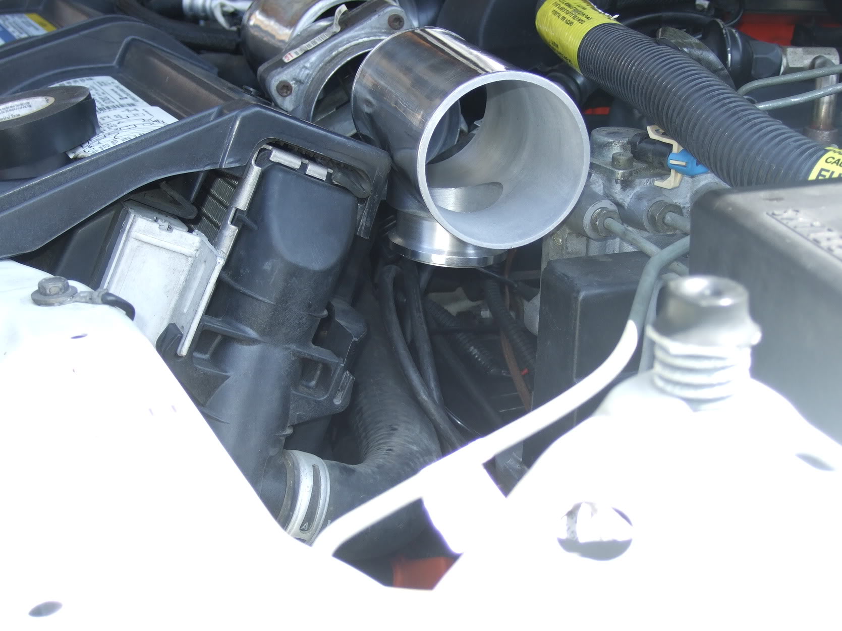

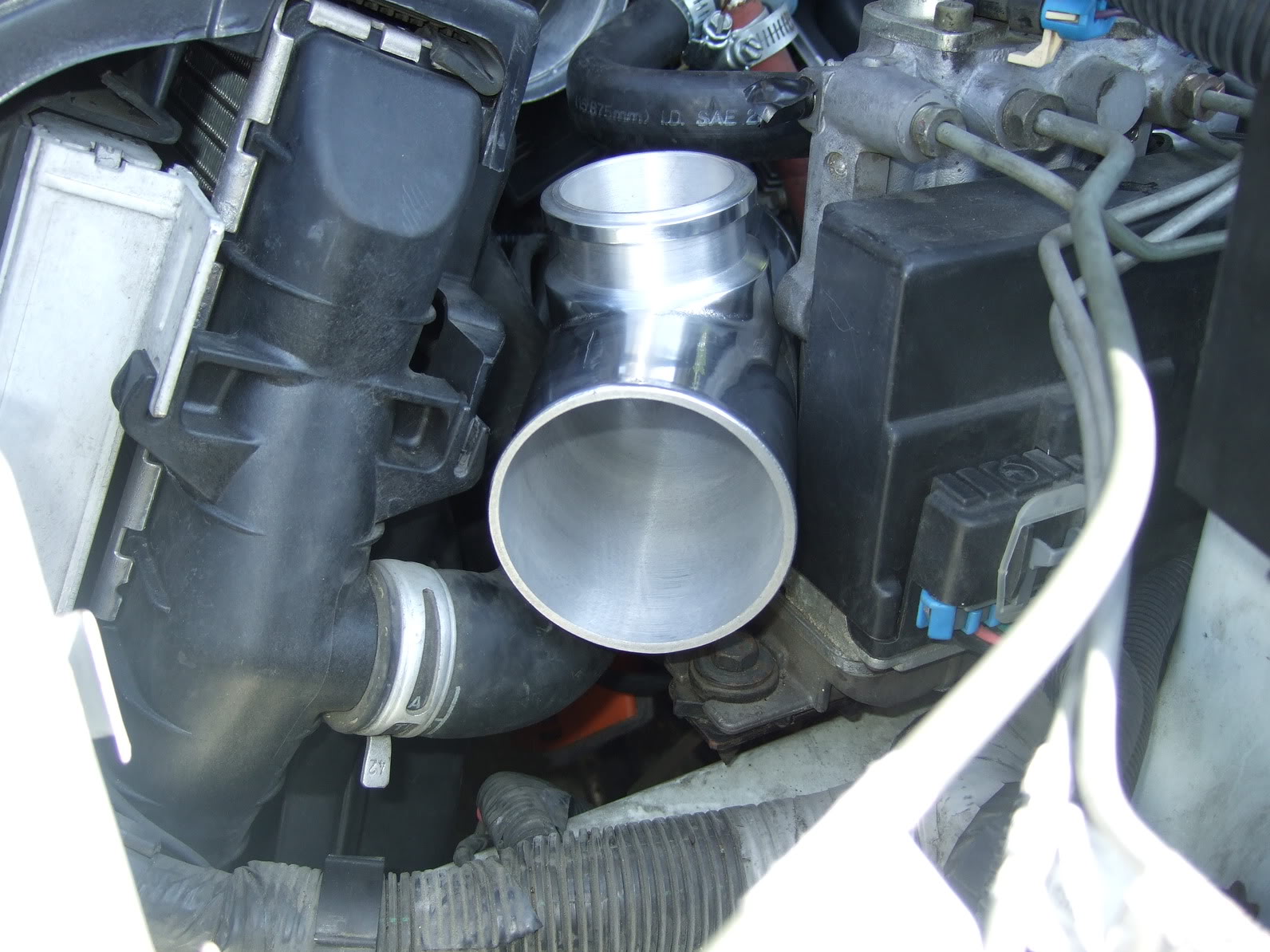

I mocked up 3" pipe and they do fit with one going over and the other under by the ABS. The bottom only needs to be 2.75" so it's even smaller than the pipe shown.
Excuse the BOV bung.
The pipe is 3". A system of 45 degree pipes and 90 degree silicone bends should actually fit. Not thrilled about the 90's.

I deleted the ABS, but I had TC as well and it needs to be deleted just to get the compressor in there. I can say that I see absolutely no reason to do an AC delete on a factory designed SC system such as the V1 or V2. I have a T-trim with 3" into and out of the front mount IC. Doing a search on here will show how to route the pipng.
