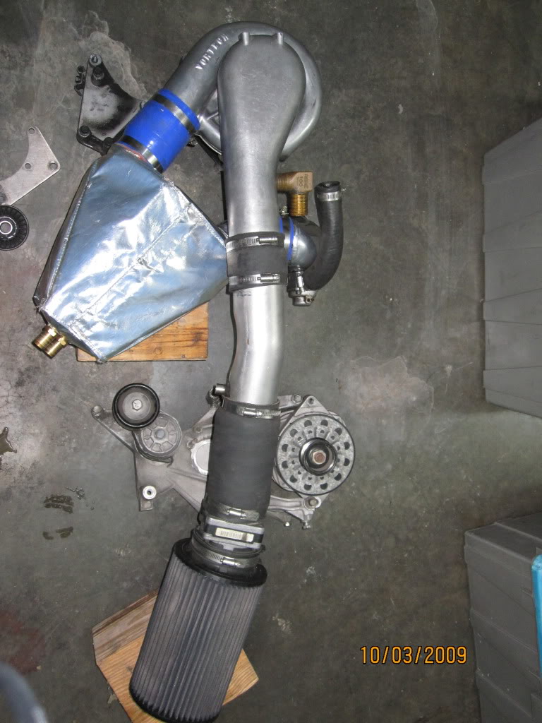

Now that I am pulling the motor and I plan to upgrade to a set of Diamond pistons, I ended up running across a Vortech supercharger kit (this is an Impala SS by the way) It is a T-trim that came off a car that utilized the blower for about 2 years, it is intercooled (aftercooled) and everything but I have questions about the attached pic I am enclosing here
#1 the brass fitting that is going into the intake pipe connects to what is a blow off valve from what it looks like in the pic? (I am asking) And if that is the case here..why were they feeding the blo-off valve BACK into the intake and can I change this without adverse results, this looks like a basic blo-off valve (if thats what it is) but I dont know for sure.

In this pic I am trying to figure if that brass fitting that connects to that rubber hose is just blo-off valve entry?

1) Yes it looks like a blow off valve. When you close the throttle quickly it gives the air (boost) somewhere to go. Without it, airflow would instantly stop and backfeed through the compressor wheel to the lower atmospheric pressure. Surging your supercharger can break parts.
The air has already been metered by your MAF sensor and therefore fuel has been added accordingly. If this air isn't recirculated and rather vented to atmosphere, you're going to run super rich. (Unless you're running a speed density tune as opposed to using the MAF sensor.)
