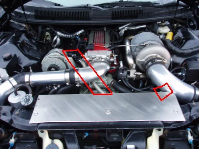

For ****s and giggles how do you have your Cranks case ventilated?
Old Jul 10, 2008 | 08:56 PM
leadfoot94's Avatar
Joined: Feb 2003
Posts: 595
From: Michigan
I'm running the stock "formed" hose that steps up to a 5/8 hose that is then connected to the intake side of the turbo. I originally had an oil/water seperator inline but took it out to allow more vacuum. (The line runs uphill so no oil has made it into the intake.)
