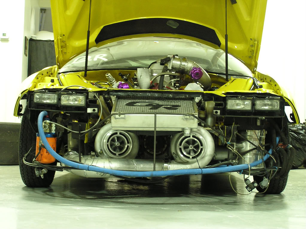

you can fit anything in these cars man....
Old Feb 13, 2009 | 10:10 PM
slomarao's Avatar
Joined: Mar 2004
Posts: 2,705
That is awesome. ****.
Old Feb 14, 2009 | 12:09 AM
1996camaroSSclone's Avatar
Joined: Apr 2008
Posts: 302
From: Ottumwa, Iowa
I'm jealous now lol. Do you have any more pics of that build. I would like to just take a look at that. It's a nice setup. I think I'll stick to by pt88 though.
